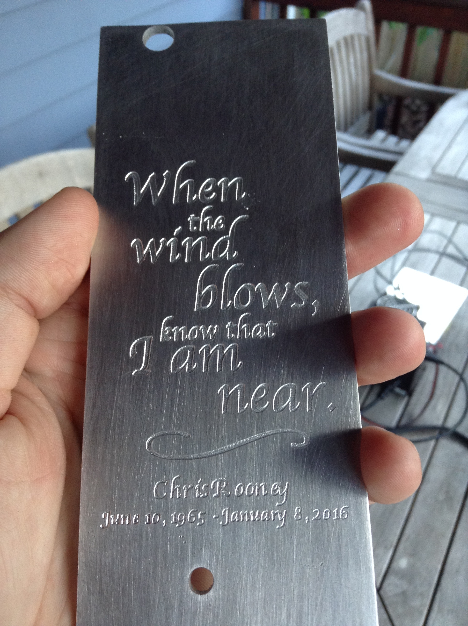

I wet sanded the surface before I started engraving. It could also be the lighting, different angles causes it to change.
It may also be from telling Easel that my bit was 0.001 in and it adjusting the step-over
Upon further inspection, it looks like it is the stepover that is causing it. Easel probably doesn’t have enough precision or the X-carve for that matter to eliminate the stepover of an 0.001 bit. The bottom surface actually looks like this ^^^^^, although very very tiny, so it is causing it to refract the light differently. You can kind of see the rough bottom in the first picture.
It would probably be really cool to see under a microscope, but that might just be my inner nerd.

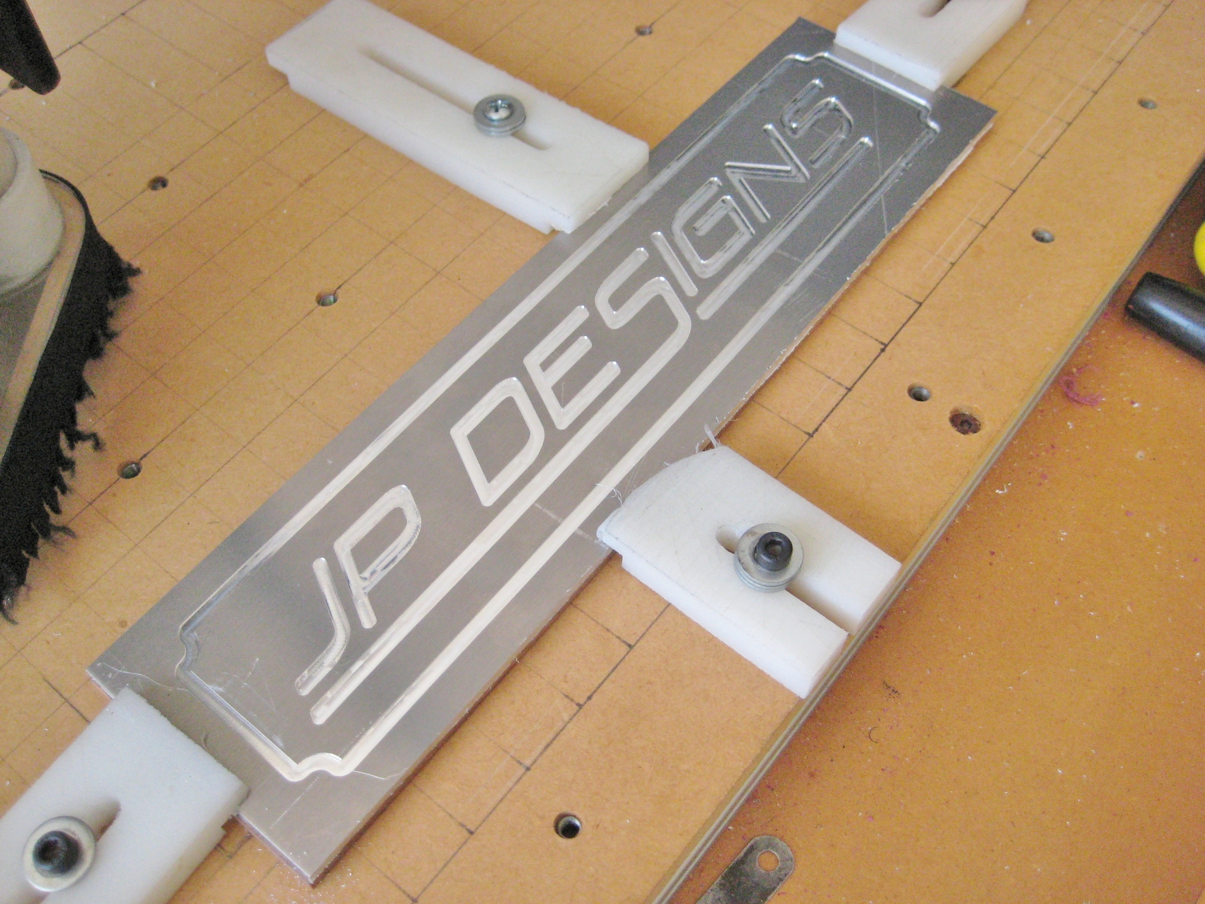

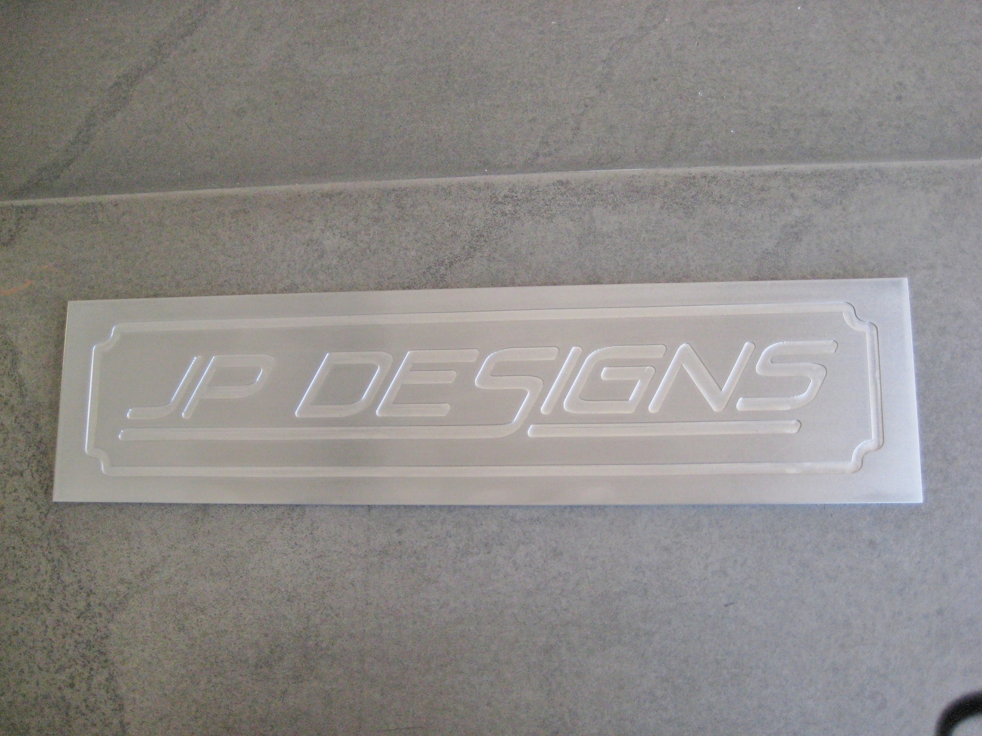

First cut with aluminum:
.125 6160 aluminum using 3 flute .125 upcut carbide bit with 40% step over, .003 doc, 50 ipm, Dewalt speed #2, cut to .020 depth. No problems, could have probably up my speed to 60ipm or more. I’ll play with setting on next one and also try 2 flute bit.
Total cut time = 17min.

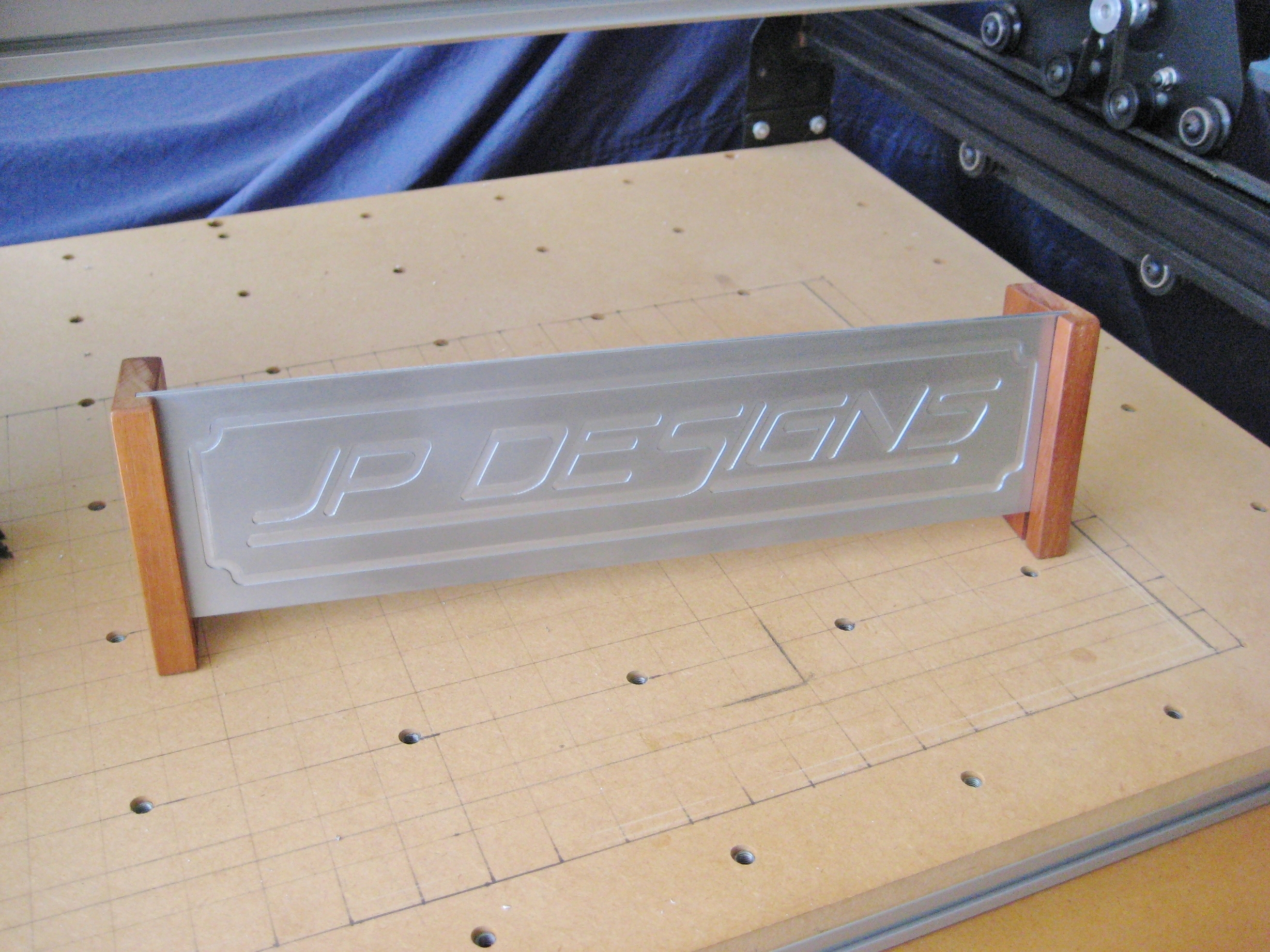

I sanded with 320 grit to remove scratches and used scotch brite type pad to give it a brushed look. Clear coated with lacquer to ward off finger prints. Turned out good for first time!
Who is JP?
Me…lol
kidding. That last photo looks awesome. I prefer the brushed look.
Nice! And good logo design too.
look like you wana be the very best… =D
Lol sister really likes them.
