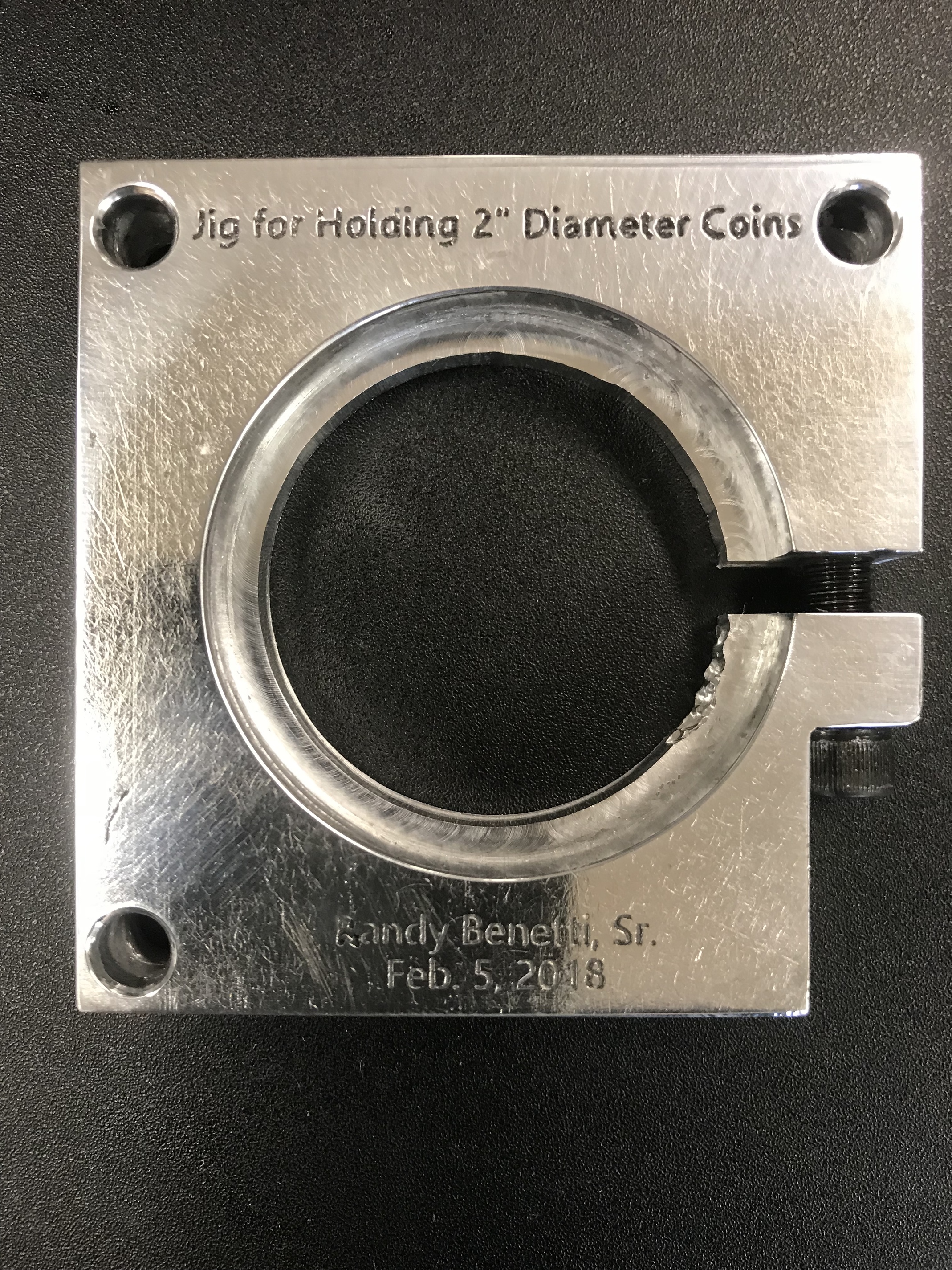

Great looking coins. I have made a few on my Stepcraft 2-840 using the same bit. Very tedious works. I used .25 x 2-1/2â flat stock and cut out the blank coins to start with. Then I have an aluminum fixture that I use to cut out both side. I use a setting on UCCNC that allows me to use a edge finder to locate the center of the jig perfectly. I like the .1875 material better as the coins are not so heavy. What are you using to tarnish the coin after cutting it? Itâs definately not simething I would want to make a bunch of coins with, but as a special purpose coin, I love it.
Wow, even the jig is cool looking. The clamp idea is smart! I use a grub screw, which is⌠less smart.

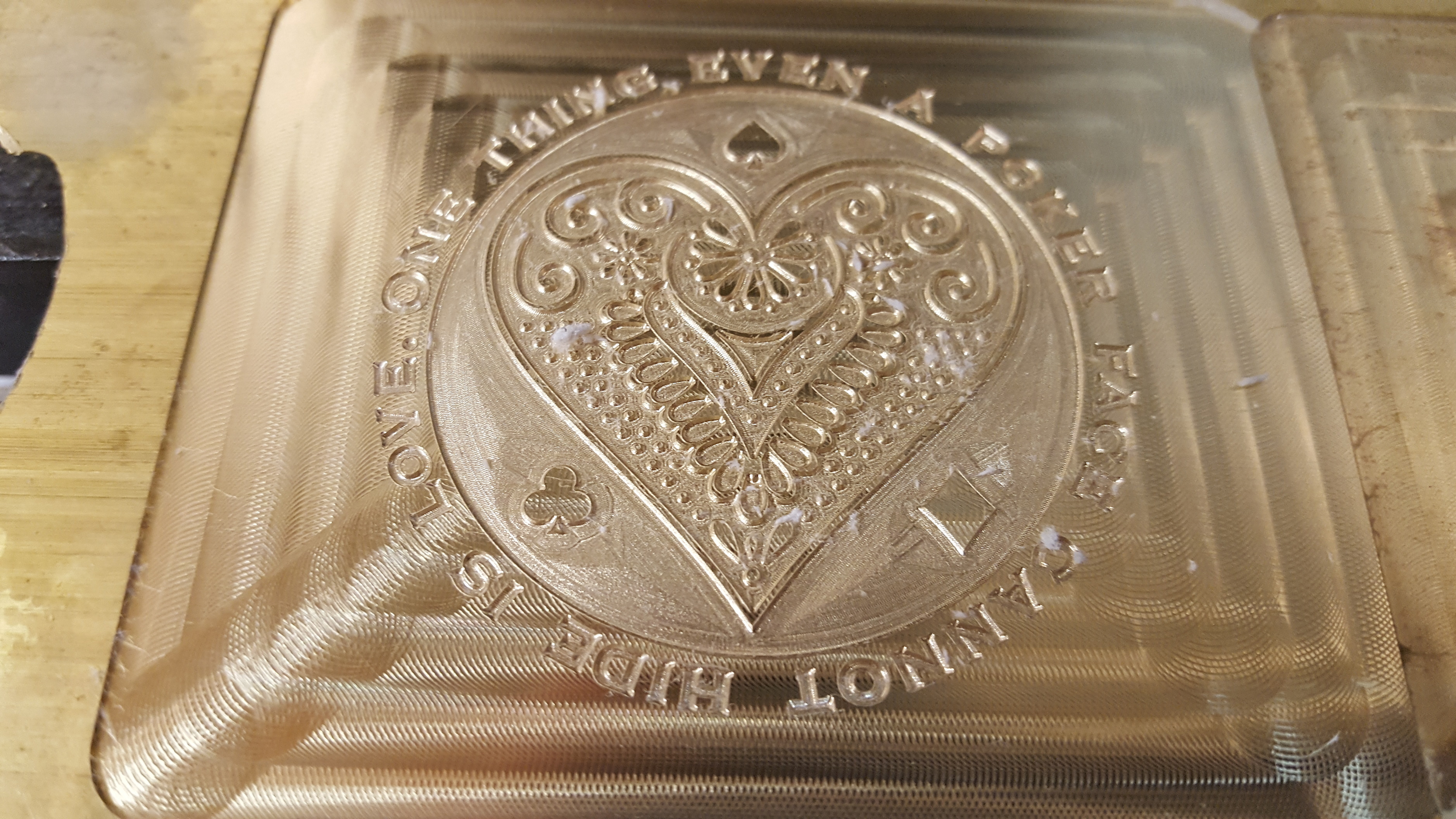

Okay, These look awesome. Iâm curious how long you think those bits last on your 2 sided 2 inch(?) coins.
For me It all depends on the quality of my zeroing process. I can get two to three coins out of a bit.
Thatâs good info to know. I was hoping they would get a little more use out of them - I guess Iâll need to not have too many âtestâ pieces!
I know the speed is around 40-50ipm and DOC is .003 - what did you set your stepover for that bit?

Dang - I tried to edit my post and deleted it. If you saw it, it was backwards. 80% stepover and THEN 50% for finishing pass. Though I have accidentally used both through finishing and could not discern a difference.
So you run a V-Carve/Engraving Toolpath at .003, 80% stepover - then come back and run it again at around 50% stepover?
Do you use any Flat Area Clearance? Or just let the 30deg Engraving bit do all the work? I realize that probably depends on intricate/detailed the design is too.
Just the v-bit. And it is a V-Carve - Youâll never get a clearance bit and a v-bit to the same level, which makes a messy bottom. Just let her run and your flats will have a nice matte finish easily buffed out. Also, keep in mind, I face mill the medal before engraving to ensure it is square to the machine.

I do not have any videos. But here is a shot after face milling and engraving. You can see what it looks like before being hit with the Dremel.
