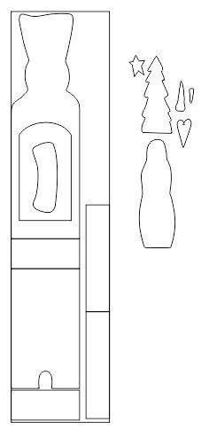

I do a lot of rustic primitive stuff. We do these characters that sit on a porch about 30-40" tall cut in basic 1"x12"48" pine. Using a 1/8" bit. How fast can we cut these and at what depth per pass?. I attached a typical layout so you can see it’s not very complex. We currently us a hand saw but would like a faster cleaner cut.
With a standard size machine, you wouldn’t be able to cut all the pieces out of a 48" long piece of 1x12. My machine has about 30" in X and Y, so you’d have to plan your cuts around that size.
As for the speed and cut depths, that depends on the bit you choose, the spindle you have, and which modifications you make to your machine. With stiffness modifications on the X and Y axes, you can cut a lot deeper and faster because your machine will have a lot less flex.
I recently made a sudoku board out of .75" thick pine (MWP Sudoku Board | Inventables), here’s the details behind my cut with the 1/8" bit:
- 3/16" steel bar to stiffen the X axis, and Y axis is braced in 3 places on each side
- Dewalt 611, set to speed ‘2’
- Used 1/4" shank 1/8" 2 flute downcut bit
- Final feed/speed was .050" cut depth and 75 IPM
Your speed/feed will vary.
