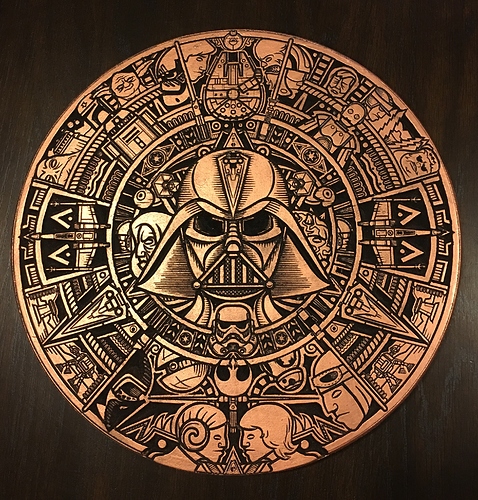

Because I don’t run the spindle or dust collection with the drag bit I set it to carve then went to bed. Aspire predicted 6 hours. It was probably closer to 5. Most the other signs this size have taken 2.5. This one has a lot of detail. I pushed my x carve kinda hard on this one, 150 imp for up to 6 hours run time.

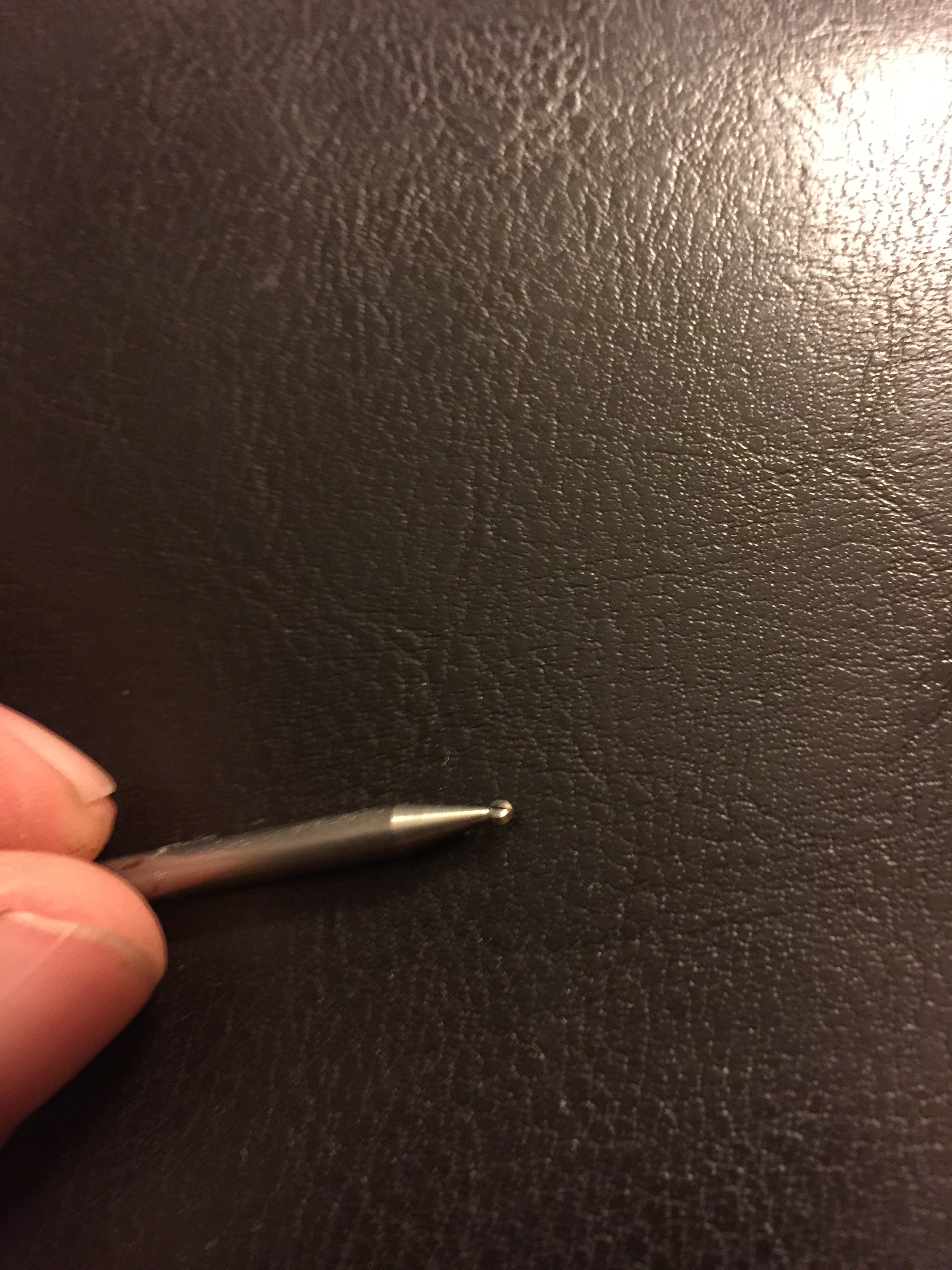

I have also used this dremel ball nose engraving cutter. The sign turned out ok. The edges of the carved area is not as clean. I don’t think this tool would work on such a detailed sign as the Aztec. I carved it extremely shallow, .003 I think, with low RPM on the spindle. The work surface needs to be very level. The diamond drag bit is way way better.
I used two tool paths, the quick engrave for the entire area with graphics and a profile tool path to cut the edges.

I am in the process of creating a drag bit. Will have more to show when I get it going. right now I just have a bit.

did he say, mineral spirit to clean off the top part or something else?
He said to use Denatured alcohol. I tried mineral spirits and it eat through the spray paint… So I was stuck leaving it darker than I wanted to. Going to buy some denatured alcohol for the next one and see how that goes.
are these how it’s been done?
1- apply shellac let it dry overnight or longer
2- spray paint it with metallic copper or silver
dry time = 4days
3- brush on acrylic black paint then wipe off top with
dry cloth then paper towel on a sanding block.
continue wiping off after each painting to keep
top clean from black paint.
4- use denatured alcohol damp it on paper towel to
wipe off the top.
This is how I did mine.
- Applied sanding sealer to entire surface
- Waited a few hours for sanding sealer to dry, then spray painted with metallic copper.
- The next day I brushed on black acrylic in sections, wiping off with damp rags.
- Once the entire thing was covered and wiped I let it dry for about an hour, then buffed it.
- I did not use the denatured alcohol. Just rubbed at it with a cotton cloth
Mine is 14" diameter. It took just under 2 hours to cut.
I have since ordered some tubes of Rub N Buff in Spanish copper, ebony and pewter colors. So I may cut another one and try that finish method.
I did similar except for step 3 I used a damp cloth and then a dry one and then paper towel wraped around a sanding block
