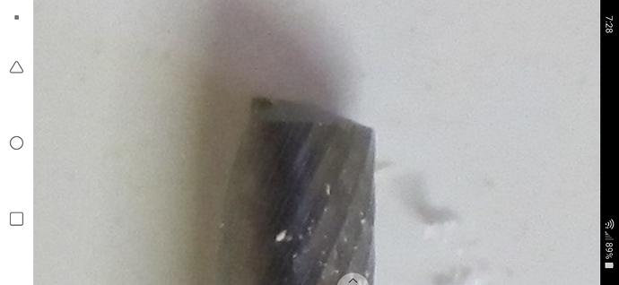

Maybe it is the angle of that picture, but it sure looks like the tip is broken in that picture.
Here is the picture of the bit from the website above. I think it looks the same.
I think we can agree this is not the right bit for the etching acrylic.

I zoomed both pics, new versus the one in his pic, and the tip is definitely g
one from his. Should be able to measure bit length.I am using a 1/16th 2 flute downcut endmill and getting a lot of crud ground into my spoilboard. Would changing the step over help with this?
