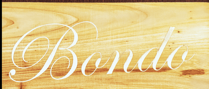

I was doing a home repair and I had some bondo left over so I tested it as a filler material. It fills very well, will not shrink and it should be easy to mix color with it. Plus it dries hard enough to sand in about 10 minutes.
This intrigues me. It would be a much simpler process than colored epoxy fill. Iāve read previously about ākneadingā the Bondo to reduce air pockets. Itās got to be much less finicky than the epoxy. My question is about the tint. I use paint for my epoxy (I know, a sin in some minds but Iāve never had setup issues with it) and it colors true to the tint. Does this work anywhere close with Bondo?
Trying to color the bondo (by adding color and mixing it well before adding the hardener) is going to be my next experiment, but I expect it will hold color well since it is really designed to be colored. Based on the quick experiment I did today it is 10 times easier and quicker than trying to use epoxy. There are no bubbles to worry about and it sands much better.
There is one downside, you cannot stain the board after you fill it with bondo, since the bondo really takes the stain.
That would make things interesting. Iām thinking about a mask over the wood, cut out and Bondo. Might be a bit tedious then getting the Bondo flat and the masking off but it could work. I would think the colored Bondo wouldnāt leach into the pocket edges thereby eliminating that sealing step. All a trade off⦠Iām interested in seeing your results. Iād give it a go tomorrow but Iāve currently got aluminum screwed to my table to cut out new gantry plates.
The bondo is sure a lot less expensive than the epoxy. A can of the stuff should last nearly forever.
