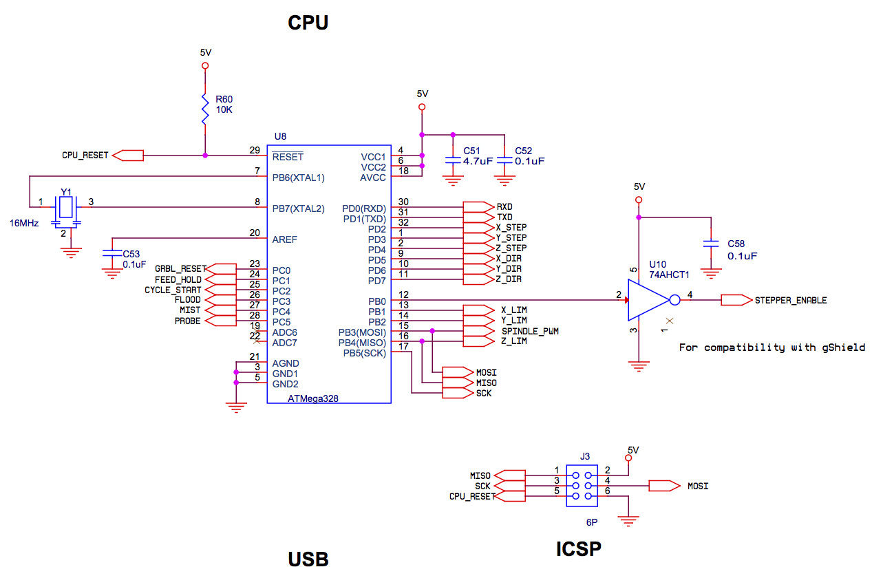

I don’t have a VFD (yet) but reading through this I was too wondering why waste M7 or M8 to switch the VFD on. Isn’t pin D13 supposed to do this?
By default this is assigned to spindle direction, but I believe by uncommenting this
// #define USE_SPINDLE_DIR_AS_ENABLE_PIN
(which btw, comes with a warning about this toggling at boot time) it should theoretically work.
It looks like D13 on the X-Controller (what comes after Z_LIM, marked as pin 17 below) breaks out to pin 3 of J3. Here’s the relevant snippet.
