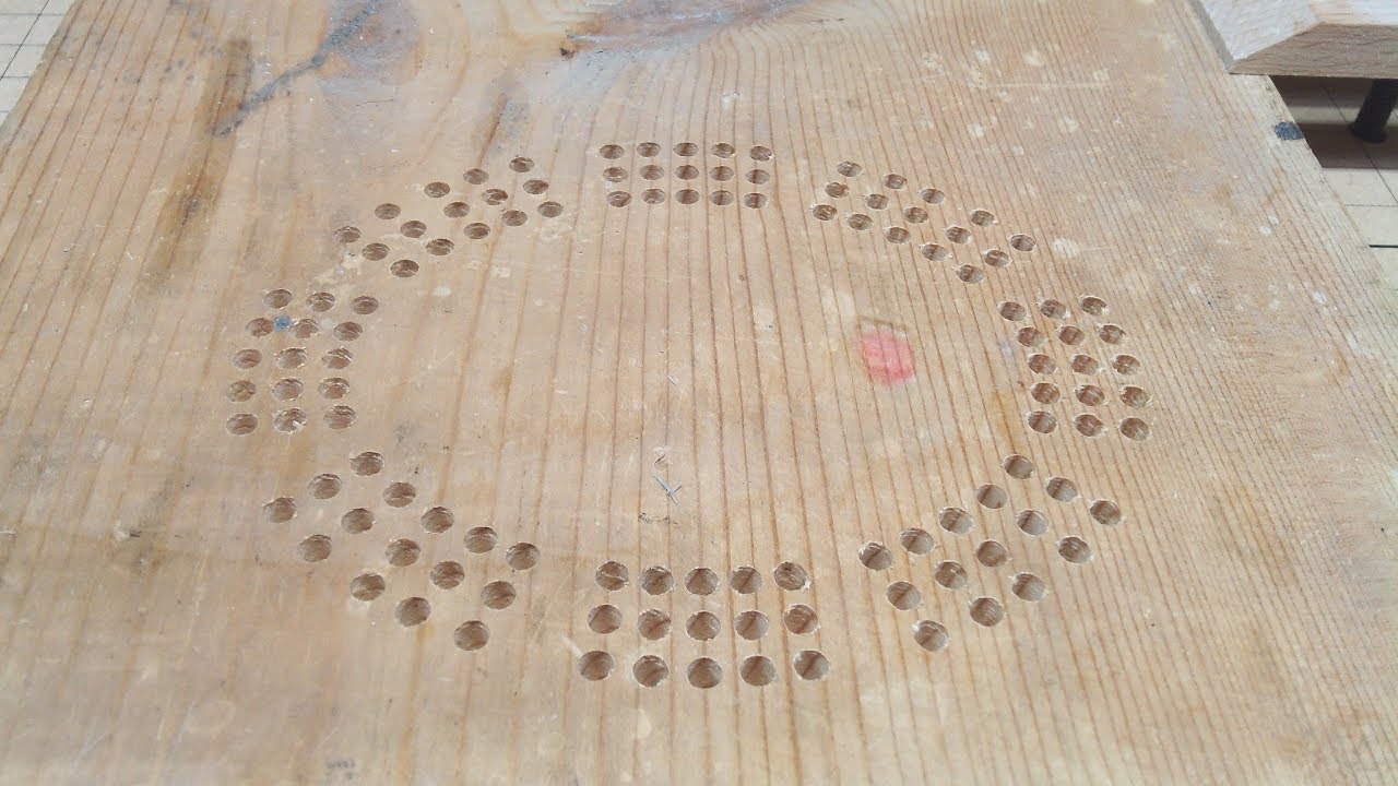

So i need to drill some holes, but i need to drill them in a particular order, not just randomly sequenced. Can this be done using easel pro somehow?.. see attached for sample of how i need to drill in this order.
Can you expand on what you are trying to do? Why do you need them in a specific order?
I am printing resin braille dots, and if done in random sequence the pad on the braille attachment that touches the surface first to engage the resin drop could land on top of a wet drop previously printed. Google Quill braille printer and you will see the attachment and how it works.
