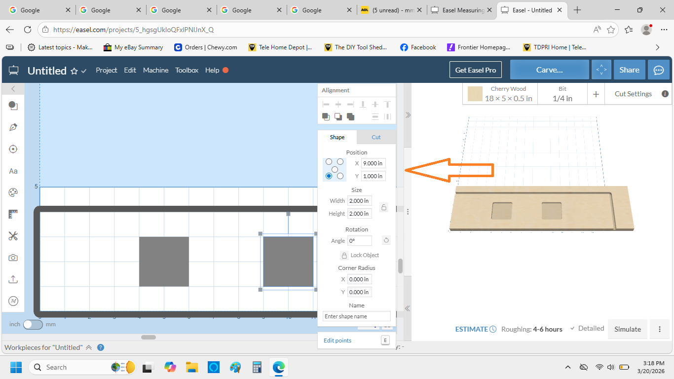

Hello,
I’m a complete newbie on Easel and have a simple question. I bought a CNC machine thinking that I could use it for architectural models. What I would specifically like to know is how to cut out windows for the model. By this I mean how to cut out holes (rectangular) on a wall. Imagine the wall is a piece of basswood 4" by 16”. I would like these holes to be placed at 4” and 9” in the horizontal direction. Can this be achieved using Easel?
Thanks very much.
Phil
yes you can dial in the location of the shape once you draw it.
You may want to look at some of the special built in apps that are available such as the replicator and the radial array subroutines. The nice feature of this program in the user groups that can be tapped into to assist you in the design and usage of Easel. These apps are in the tool box on the left hand side of the screen. It’s behind the wrench/screwdriver button if you scroll down a bit after left mouse licking on it.
Enjoy
Ron
