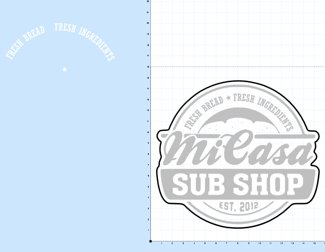

Not sure if this is the same problem but it is similar. Working on the sign below and noticed after completing the carve that the area inside the “B” and the “P” was cut incorrectly. On closer inspection it appears that the Roughing cut plunged about .038 deeper than the .125 entered. The V bit did its job but obviously had nothing to cut in these voids. Also noted that the dot over the letter " i " in Mi Casa was also cut the same amount too deep but it was smoothed so not readily noticeable.
I have shared the project in the link below. Any suggestions as to what went wrong?

Hi @RayMacke, I’m sorry for the trouble. It looks like inverted some of the text in your project after you did the carve in your photo, but I tried swapping the “sub shop” text and background depths and did see some strange toolpaths in those two letters:
Notice the two overlapping sets of finishing toolpaths (dark blue). That appears to be a different bug.
I’m not sure yet why it’s happening, but it appears to have something to do with some extra shapes hidden behind the “sub shop” text and background:
If I delete those shapes the toolpaths look normal:
I’ll file a bug and we’ll look into this further.

You are correct - it appears I inadvertently inverted part of it while trying to figure out what went wrong. Didn’t notice the extra objects and not sure where the originated but as you said it appears a bug allowed them to effect the carve.
Don’t know it it will help troubleshoot the situation but I noticed the problem seems to be tied to the cutout border surrounding the sign. I had it zeroed out so it was not readily visible (have brought it to the surface now). BUT if you delete it the tool paths appear to me to be corrected. The extra objects are still there but don’t seem to be causing a problem.
Thanks for looking at this for me. For now just deleting the excess junk seems to fix the problem.
@RayMacke, we fixed the issue you have reported. Now easel automatically exclude those extra shapes.
