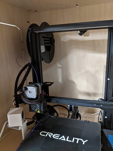

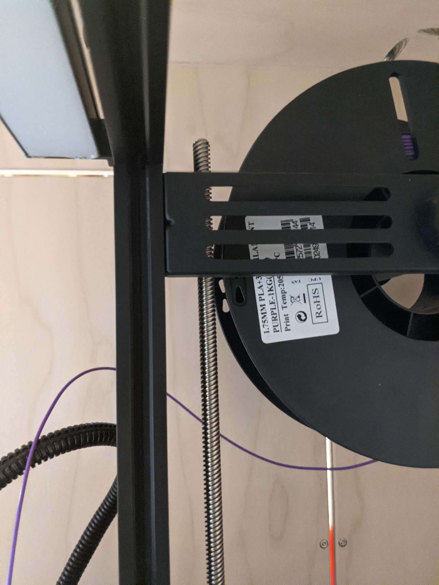

Fusion no longer allows downloads from the link, but I’ll see what I can do when I get to my desk. Below are pictures of my spool holder location.
