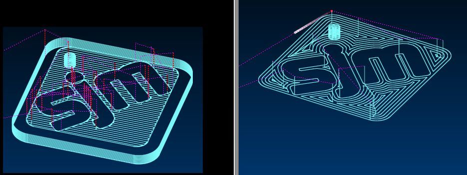

I just came across something very interesting that relates to this. I cut one part in Easel, then used EstlCAM, which I am testing. The finish difference was striking (ignore the border on the one to the right)…
…so, then I looked at the g-code with a new app that I just saw tonight.
Easel on right this time.
Holy cow! Not an arc to be found, even though grbl has supported them for a while. This translates to 1,765 moves vs. 811. That’s big.
It is even a bigger difference than what Tony is showing. I ran both Gcode files on Gwizard Editor and removed the outside profile so both cut the same. This reduced the line count to 665 for the EstlCAM file that uses arc moves for all the radius cuts.
I think that Inventables Easel programmers need to look at how they are dealing with Arcs and make the changes needed to reduce the line count and make better arc moves.
