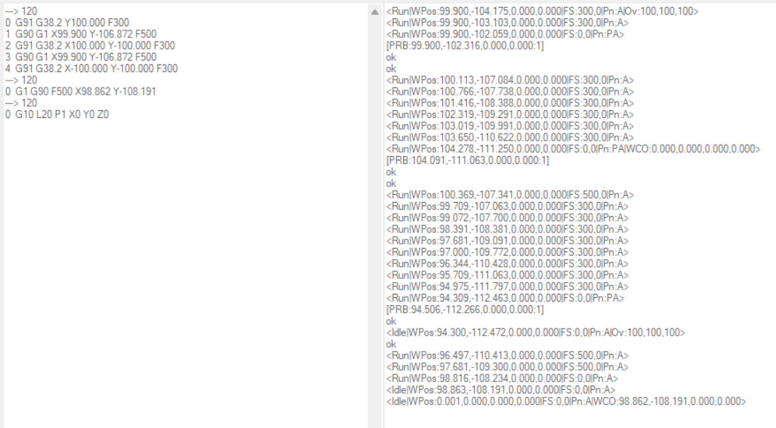

It is actually reproducable. The routine will always work as intended:
- after homing the machine
- after resetting the controller
Here is an OK align circle routine:
Here is one I took right after the first one above, this one failed:
And here is a third one which I made after resetting the controller. This one was again OK:
When it fails, the machine is running towards +X and -Y. Correct direction would be +X and +Y
You are right. I was able to understand the error from your records.
It is a problem of the conversion of the coordinate systems MPOS / WPOS.
The measured values are sent in MPOS and must be converted into WPOS. This did not work in the one case.
However, the error does not occur on my test setup nor on my machine.
So I could only do some precautionary checks in the new version V5.1.14 and output some debug displays. This includes a display of the G54 value, which contains the conversion MPOS / WPOS.

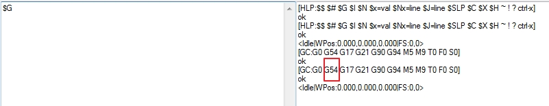

I still have two questions for you:
- can you please tell me what GRBL settings you are using. Command = “$$” (pic1)
- can you please check if G54 is your Select Coordinate System ? Command = “$G” (pic2)

$G
<Idle|WPos:0.000,0.000,0.000,0.000|FS:0,0|Pn:A|WCO:0.000,0.000,0.000,0.000>
[GC:G0 G54 G17 G21 G90 G94 M5 M M9 T0 F0 S0]

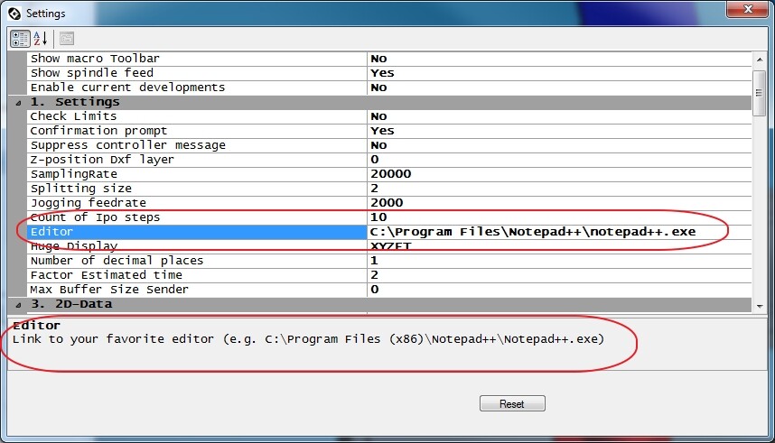

I just want to briefly draw your attention to the new Notepad++ plugin.
It offers great possibilities to debug GCode. This now includes graphical output in addition to the well-known syntax highlighting. What makes me especially happy is that for manipulating the graphic the same mouse actions are used as in my program ![]()
If you specify the path to the Notepad++ exe in the settings of GrblGru under ‘Editor’, the calculated GCode is displayed in the toolbar at the push of a button.
But of course Notepad++ can also be used to display Easel or X-Carve generated GCode. ![]()

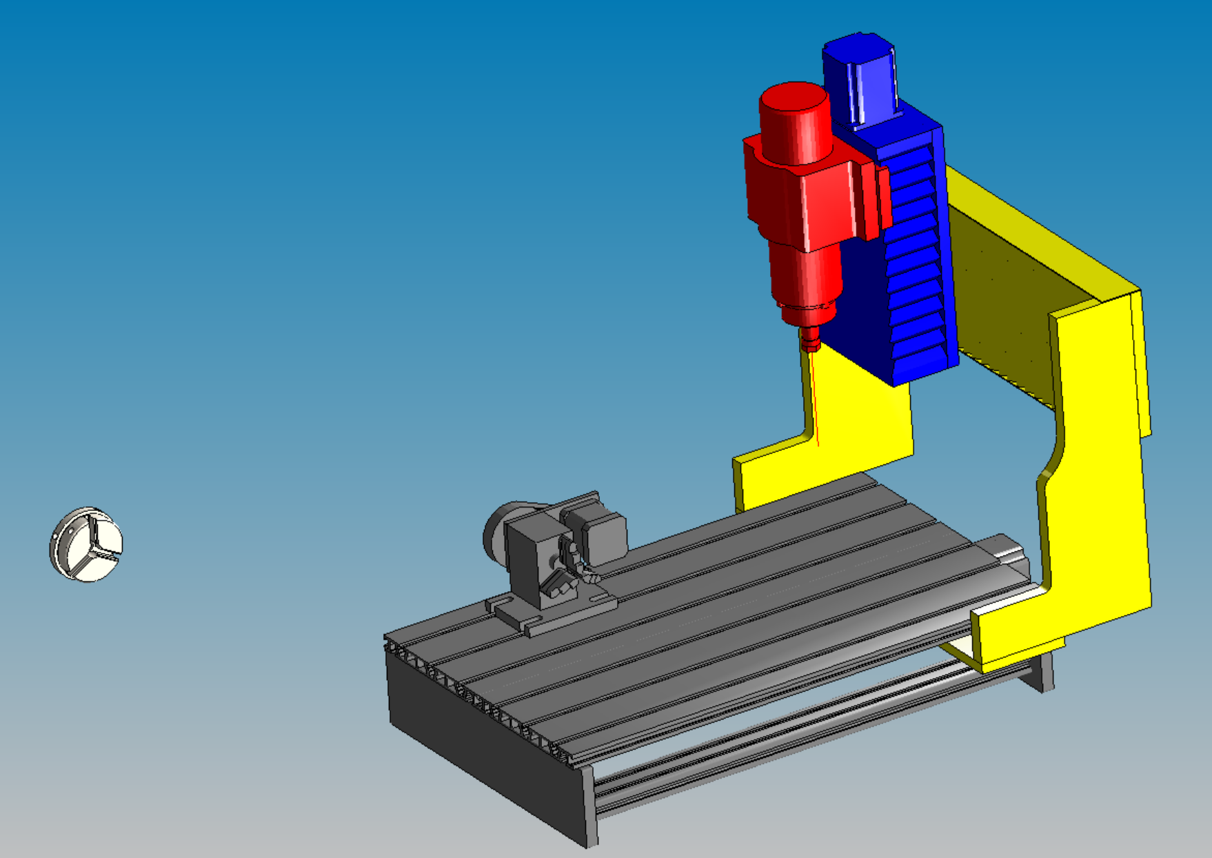

Hey @GrblGru, I am reporting an issue I have seen some time ago but did not really have the time to wrap my head around it… Something seems off with the reference point for the rotational axis. This is how my STL model looks like in FreeCAD:
This is how it looks in GRBLGru:
It seems the chuck rotates around the correct axis position, but its position is not concentric as it should be according to the STL files. I had it working in an older version once. where I found out I had to position the chuck to the machines zero position. Other XYZ+A axis machines seem to have the same issue (checked in v5.2.2)
@Roman, thank you for your feedback. I have been working a lot on the 4th axis and 5th axis recently. Perhaps I have inadvertently built in a bug. Can you please send me the STL files from your machine to GrblGruNoReply@yahoo.com.
Then I can take a closer look at why the error is occurring.
If you agree, I would also be happy to include your model in the program.

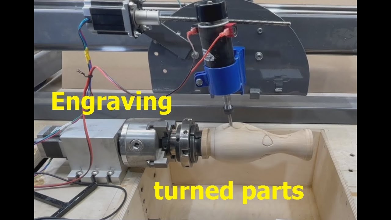

Today, after a long time, I would like to introduce you to a new function in my program.
In the past, it was already possible to machine round components, but the machining options were limited. Now, however, it is possible to machine rotationally symmetrical components in a similar way to components machined on normal 3-axis machines. Machining methods such as CUT, POCKET, CHAMFER and even V_CARVE can now also be used on the rotary axis.
The video only provides a general overview of a possible process. Basic knowledge of how to use GrblGru is assumed. More detailed descriptions would have driven the length of the video to infinity.
Unfortunately, I do not yet have a suitable machine for such processing. The image sections shown in the video were kindly provided by a friend.
All the processes shown in the video can be reproduced in the simulation mode of GrblGru. I am happy to answer any questions you may have.
Have fun trying it out. ![]()
