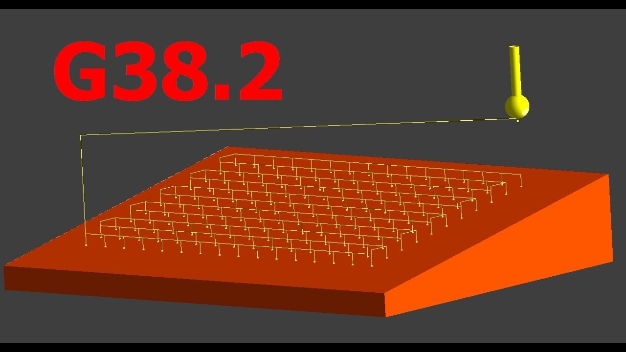

Release notes V3.38
In my new program version V3.38 I once again worked with the function G38.2 for milling.
This good and at the same time easy to use function makes it possible to scan uneven surfaces, e.g. to engrave them afterwards.
The same applies to the production of PCBs, where any unevenness must be compensated.
GrblGru also offers the possibility to scan STL objects in simulation mode.
Download, as usual from my website at http://GrblGru.com

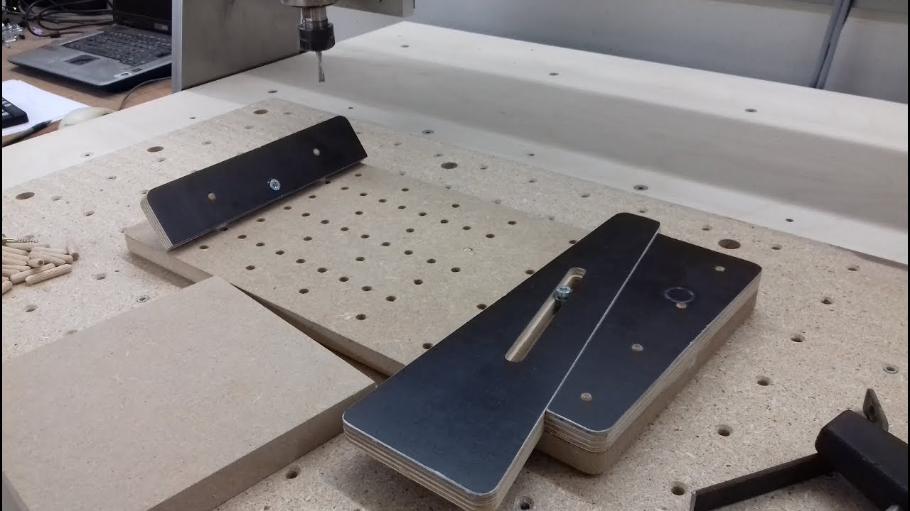

Release notes V3.40
I have recently been repeatedly referred to the clamping board I used in the last video. That’s why I decided to introduce my self-made clamping system and of course the small clamping device.
For those who want to try it out in practice, I have also included a template in the program. This should make it possible to create an individual, tailor-made design.
As usual the short video shows the necessary handling.
The program version can be downloaded from my website. http://GrblGru.com
