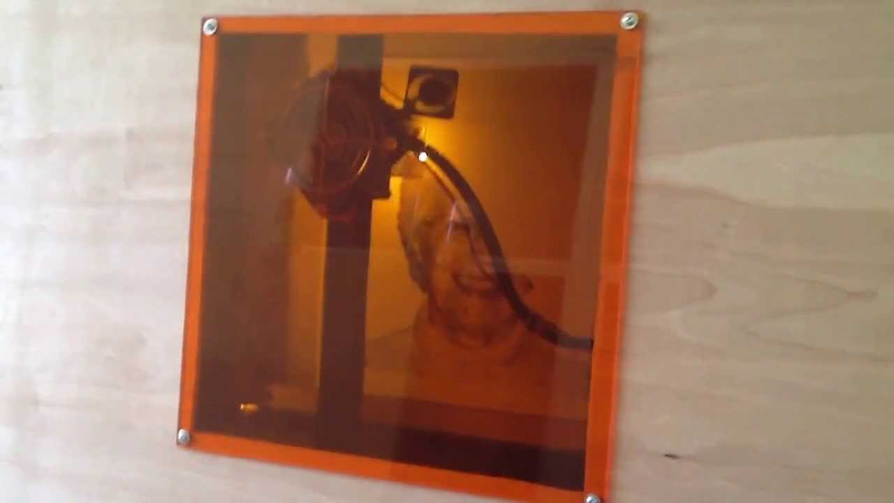

We have few different laser diode engraving machines here. From 2W-6W and they are controlled with an analog modulated driver with Z,A,B,C or S commands depending on what controller we use. Our PicEngrave Pro 5 will interpret the shades into settable depths of cut for spindle use, or for laser power and can generate those commands and more. There are many ways to manipulate the colors/shades in an image to get different results.
We also have a 3040 CNC with a 4th axis that we can laser engrave images on round materials. PEP5 will also generate 4 axis toolpaths for using with a spindle or laser in Mach3.

Sure, we developed the varied intensity laser diode photo engraving process, so if you have any questions we would be happy to help you get it setup.
If you want an out of box, just attach & wire it up system, the J-Tech laser kits are your best option.
I think we are now hijacking Evannās thread. I will answer this one last laser question, then if anyone has more questions of me, ask them in one of my laser engraving threads here on the forum
We donāt sell lasers, only programs to generate and stream the gcode to control them.
If you want to start with a good frame and add Aduino UNO, stepper controller, laser & driver yourself, I would recommend an X&Y stage from here.
http://www.lightobject.com/X-Y-Stages-C64.aspx
Our Software engineer John Champlain has built a laser diode engraver setup from one of them and it works very good.
