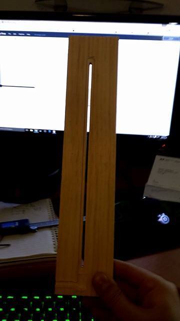

Yes I fixed my easel document both slots set at 31mm. Double checked before carving. About to flip right now making sure the edge of the board on the y axis is still agaisnt the y axis when I flipped the board. How do I check squareness of the gantry?
Hmmm fixed that. I don’t think that would affect the smaller slot though would it? Because right now the only big problem I’m having is the slot not cutting out and meeting the other slot.

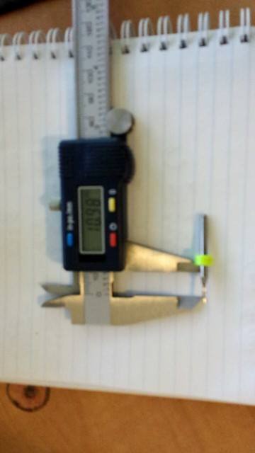

I’ll try checking the squareness of the gantry after this cut finishes with my digital calipers

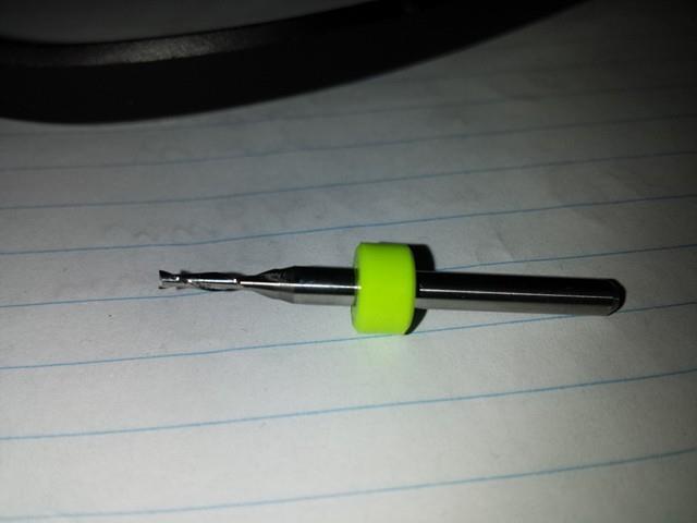

I don’t think the bit I have is able to go that far down, let me send a picture of the bit. I figure the bit can only go down so far since the bottom part of the bit is thinner than the top of it,
If the depth goes past the cutting part will it not ruin the slot? Should I just cut down as far as I can, and then make the slot for the LED strip deeper to compensate?
“Without a PERFECT pin setup, there’s no way you could get the 2 small slots to line up.”
Oh… then maybe that is my issue, I was under the assumption that if I could get the zero to be exact that It wouldn’t be a problem to line up the slots or at least get them to be almost identical. Right now they are off by quite a bit.
Must of been the bump stop! Here is my base i cut after using the new bump stop, the two slots line up perfectly!
