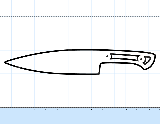

Iāve been pulling my hair out as I too am having the ācheck for open paths and join them before importingā error when trying to an inside or outside outline. This is from a dxf file created in Inkscape.
I have followed the video that @MidnightMaker kindly added to this thread and have joined all nodes which are adjacent.
This is clearly to do with something I am doing wrong as I know that the softawre is smarter then me - anybody got any ideas.
DXF file attached.
chef_knife_copy.dxf (12.6 KB)
Did you design the knife in Inkscape? The lines arenāt connected
I made each line a different color for visual.
yes - drawn in Inkscape (itās all new to me).
I have tried combining the lines and connecting the nodes but always get the same issue.
I imported your DXF into CorelDraw and converted the lines to objects, then saved as an SVG then imported into Easel. Iām not sure how its done in InkScape.
