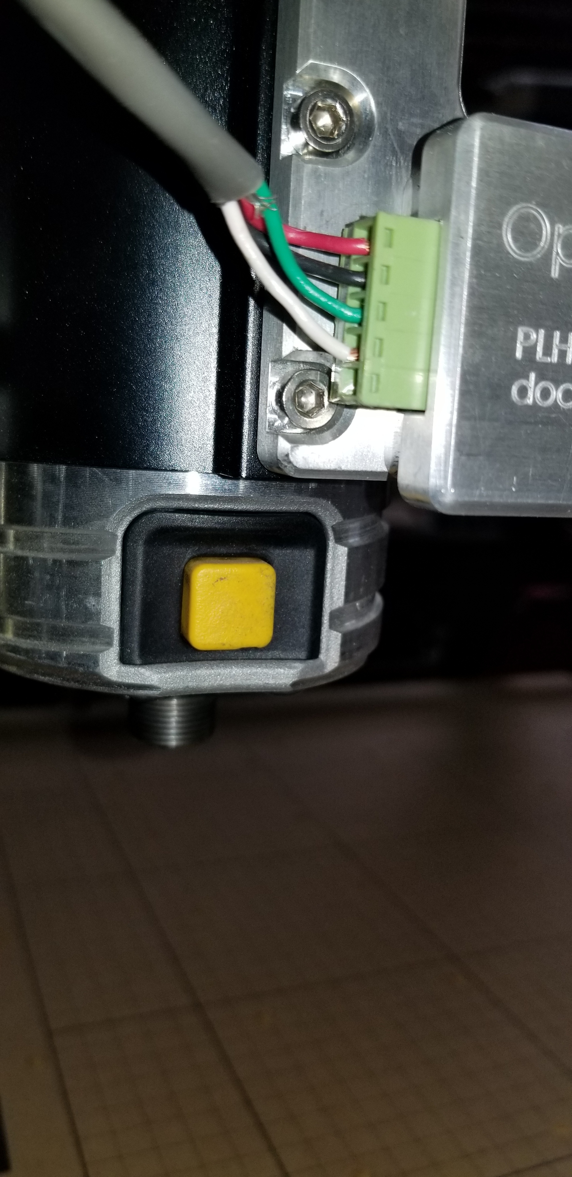

These show my wiring between the spindle mount docking station and the x controller.
Red goes from vcc (DS) to 24v positive (XC)
Black goes from gnd (DS) to 24v negative (XC)
White goes from ttl (DS) to pwm (XC)
green goes from signal gnd (DS) to GND (XC)
The traces on the docking station pcb are sized differently for the power side than they are for the signals. If you mistakenly run the power on the signal side, you can burn out the traces on the pcb quickly.
