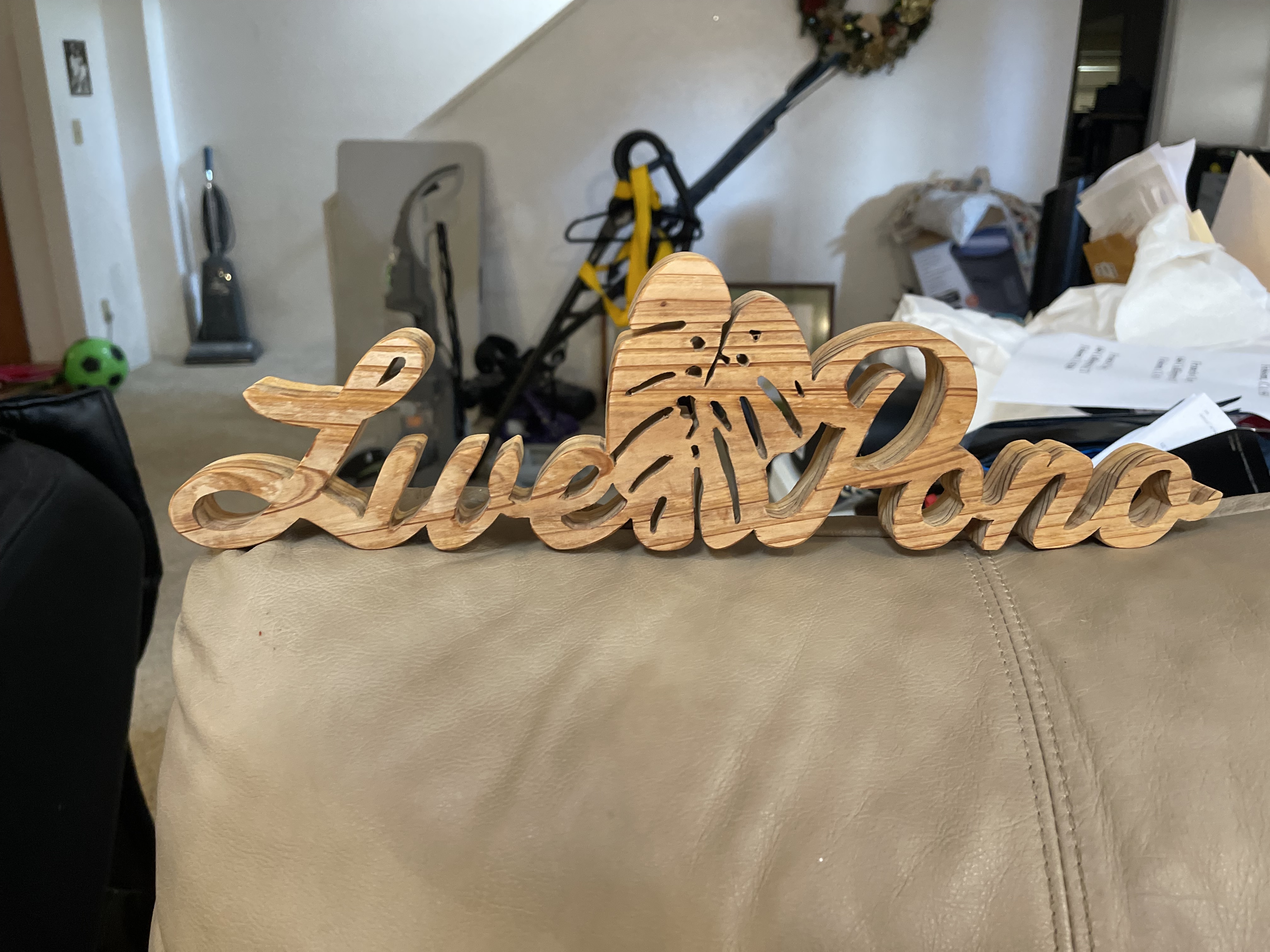

Thanks for the reply. I have attached
I cut this with a scroll saw and trying to cut it with Easel. I am having problems trying to cut the monsteria plant portion. Due to the desired thickness of the material, I am limited to 1/8 inch bit. I am trying to get as close as possible.
