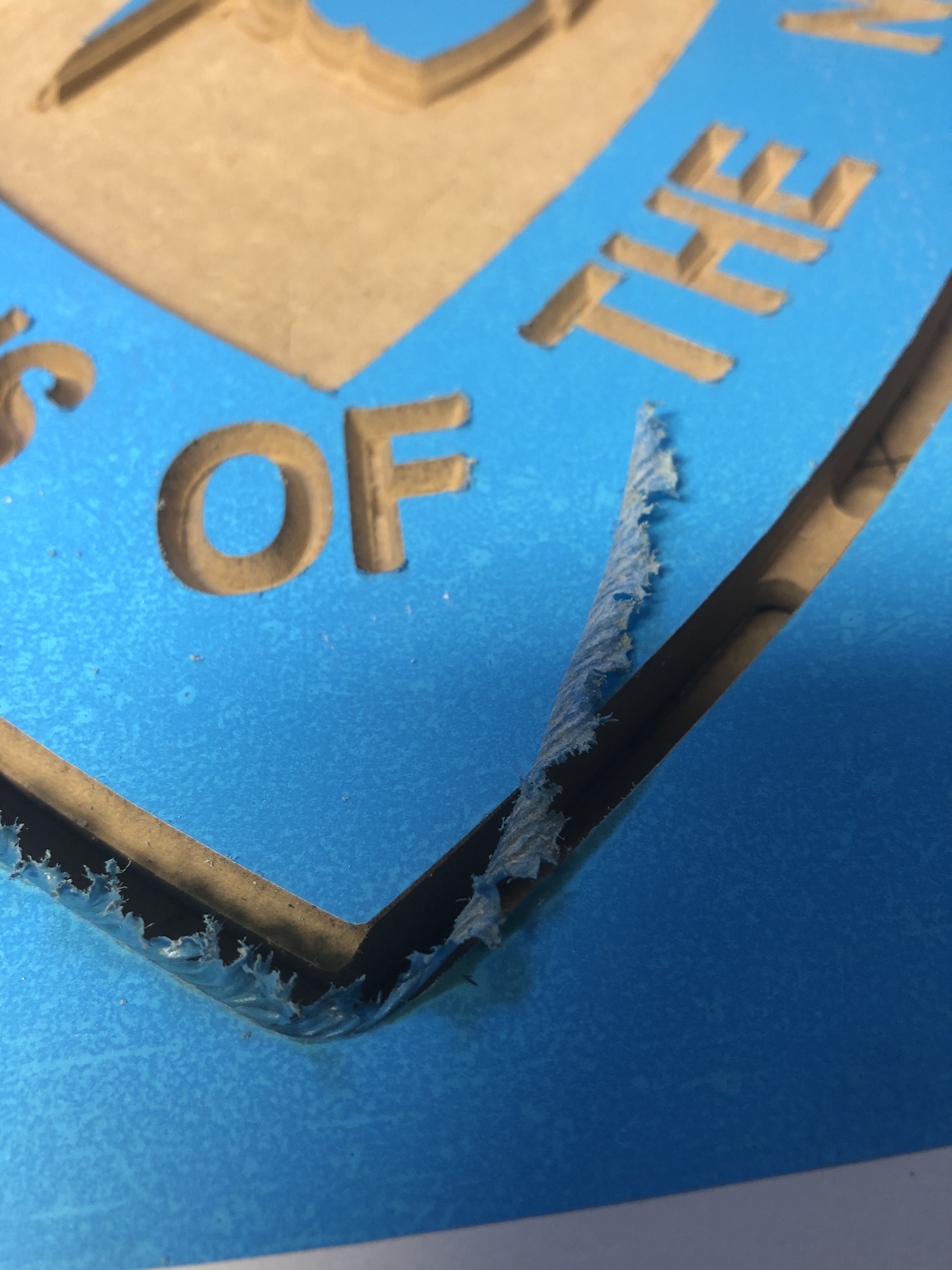

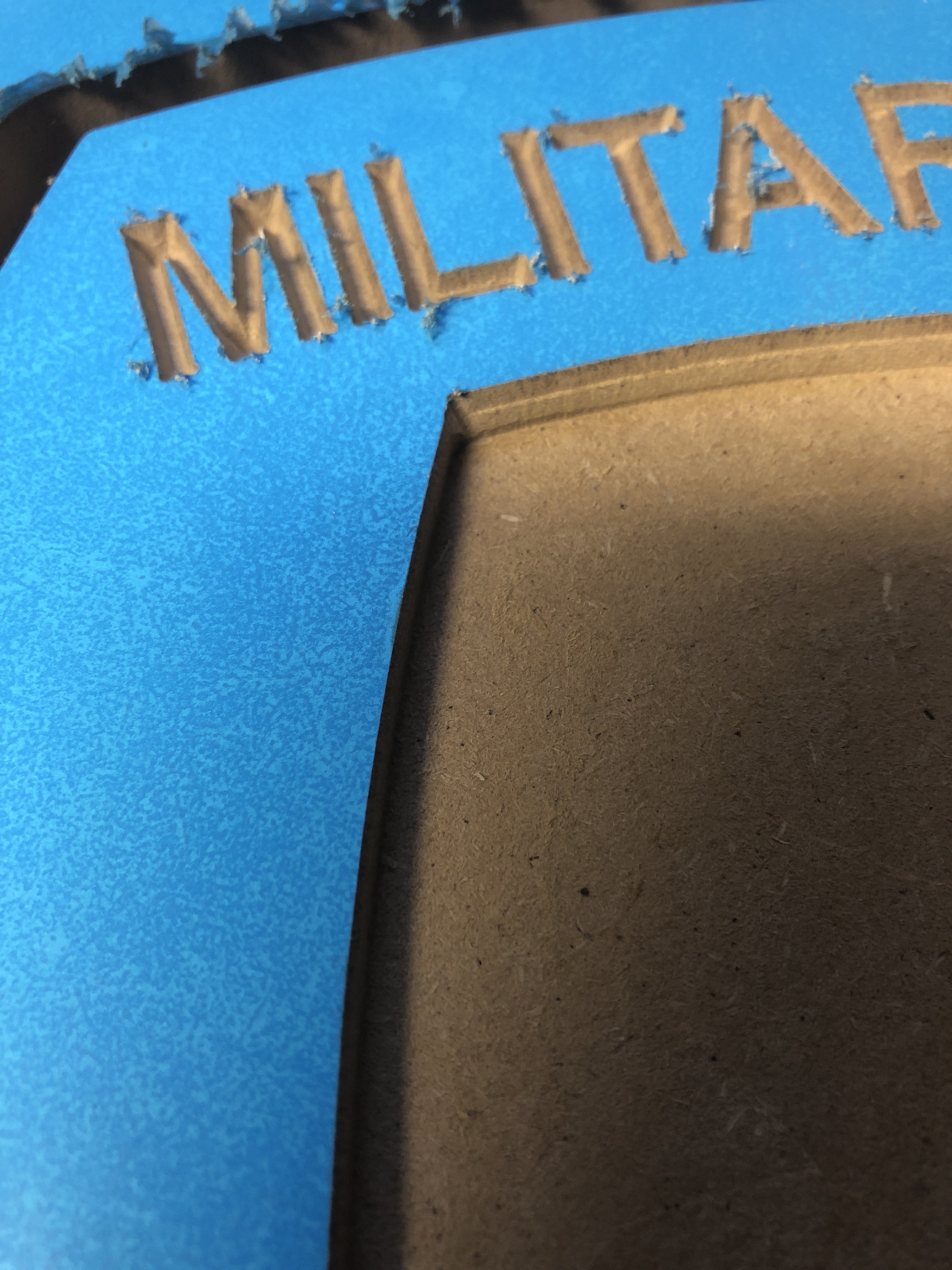

Evening update. Thank you for everyone’s input. I dabbled a little bit with Picsend, then tried CNCjs, but ultimately ended up using Easel to make the carve. However, after 5 attempts, I continued to have pathways off between bit changes. I only re-probed after the bit change, kept the existing home location, and off it would go, cutting nearly 1/16th-1/8th inch off path. My Y-Axis Carriage feels snug up and down, and doesn’t have any play in it, but seems to move way to easy if accident bumped. Tomorrow I’ll give everything a once over and try again.
