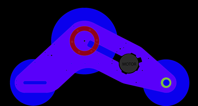

TRACKDRIVE-LEFT.PDF (1.8 MB)
FULL size Johnny 5 CAD they all are in Solidworks.

[TDRV-RGHT-A-INNR-00] Side Plate (Right, Inner).PDF (404.1 KB)
[TDRV-RGHT-A-OUTR-00] Side Plate (Right, Outer).PDF (319.5 KB)
