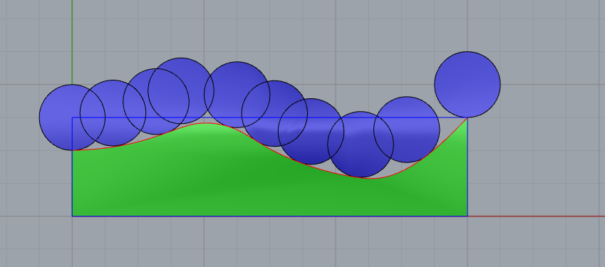

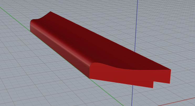

Using a 3d program, you can do the more complex stuff. Since I don’t have Easel Pro, I don’t know if this is doable. This is Rhino3d
I would mention that with straight tool paths with a round nose bit, you could offset the X toolpath and vary the Z depths to achieve a rougher version. Which is do able…but a lot of work. Blue round nose bit. Green material. Red line is the resultant shape after sanding.

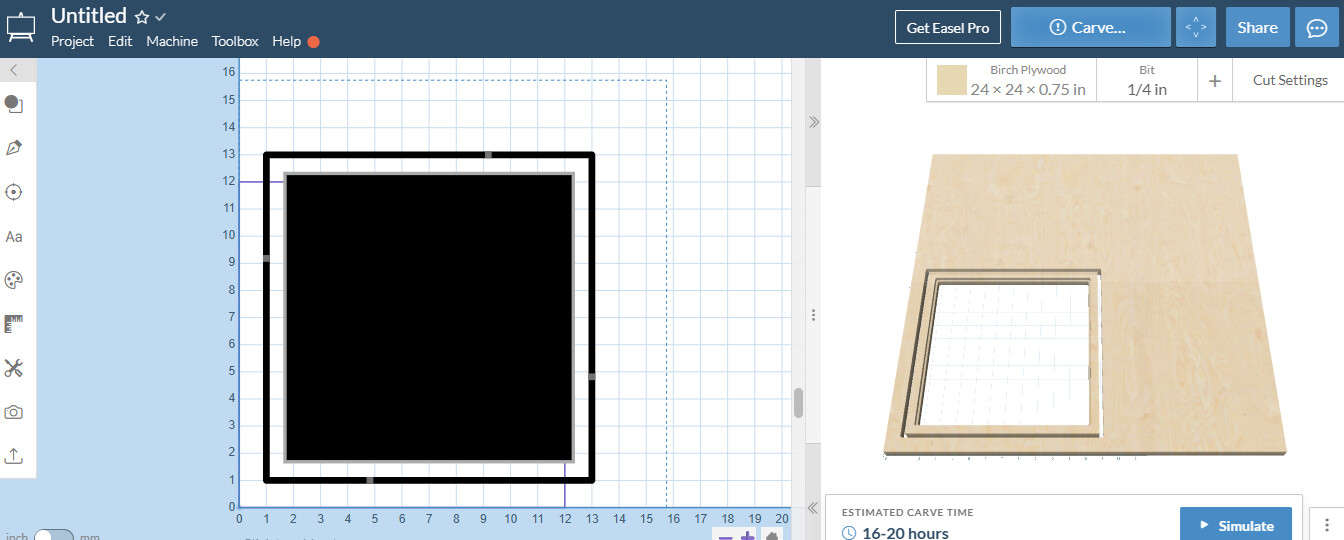

The app in easel pro works great on frames. May need to make the frame insert a little larger than default and of course you have to square the corners. I also use a flat stapler to apply those little staples that hold the back of the frame… see pic below. Get some thick poster board and staple it in. For glass, I buy cheap frames with and just steal the glass which is less expensive than having hobby lobby cut glass.
