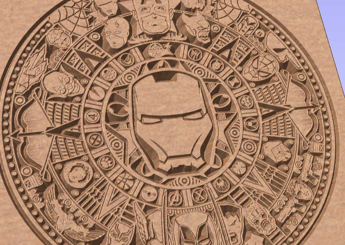

I haven’t cut it, but using the same bit he used in V-Carve generates perfect toolpaths.
I used the crv3d file but the ai file worked too I used aspire 8 , I went ahead and got rid of a couple duplicate vectors before I generated paths

Since it’s ‘open’ to the public. Could you generate the gcode from vCarve and share it or does that app not allow that? I don’t have vCarve and Easel can’t handle it.
I can do that, but I would never run a g-code file generated by someone else. If you are willing to take full responsibility that if the file twists your x-carve into a knot it is not my issue. I would need all the settings that you want to use.
hmmmm, not sure what settings you need. Standard cut settings for MDF I suppose. I’ll use a 60 degree bit cutting .75" MDF.

My standard settings are probably not the same as yours.
I need:
feedrate
plunge rate
stepover
pass depth
Z safety height
flat depth
zero in center or lower left corner?
zero on top of material or on wasteboard?
EDIT: Does your v-bit come to a point or does it have a flat? If it has a flat, how large?

Feedrate 50 IPS
Plunge 20 IPS
Stepover 5%
Vbit stepover 1%
Pass depth .05
Z safety .1"
Flat depth (not exactly sure what this means)
Zero in lower left corner
Zero on top of material
vBit is a point, not flat tip
Flat depth is the deepest limit that the v-bit will cut, with no value it will go as deep as it needs to go…
is the V-Bit 1/4" diameter?
This is 0.2" flat depth:
This is no value:
Oh…I like the NO VALUE version. Yes, my 60 vbit is 1/4".

Your settings are 11.5 hours to cut.
Hmmmm…can you make it faster?
What speeds did you use?
My x-carve is not even close to being stock, my settings will not work for you. I’ll play a bit with the settings…
Ha! I’ll get there someday…little by little I’ll beef it up. With every Christmas and Birthday, I get a little bit more.
The biggest factor for your overall time is the Pass Depth. I can do a couple g-codes and you should test it out.
