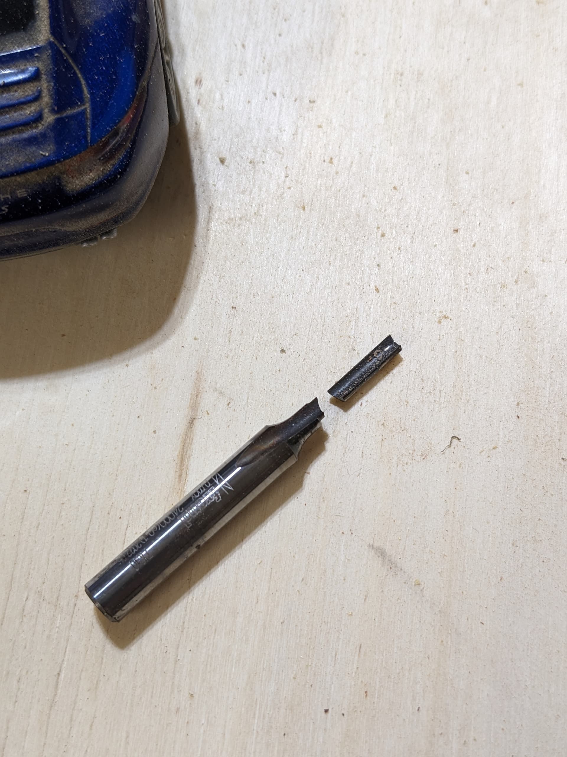

I changed out to a 1/8th bit, and broke that too.
I had to make many adjustments in speed, and redid the whole job on mdf before trying on the zebrawood again.
With more time and attention, I was able to succeed with the cut.
