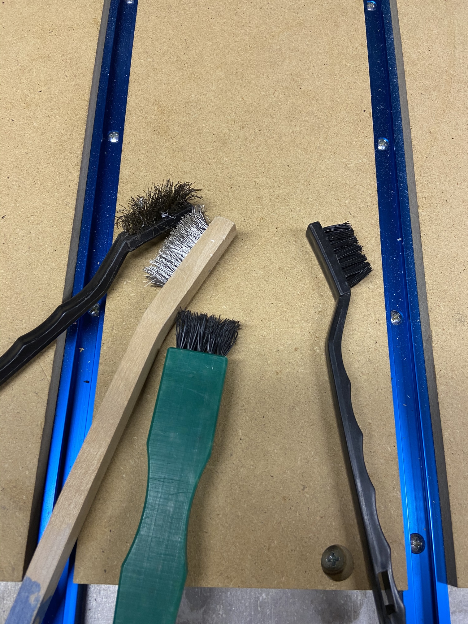

Also, can you recommend a brush? Should it be a wire brush?

I use a few different ones, just whatever I can grab. But the green plastic bristle brush is the one I use the most. Iâve seen people use the little wire brushes on a Dremel and that works good
Edit: I need some new ones
