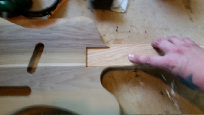

I do!!! Iâm starting to get the machine dialed in and my drawings!! Thank u all
That looks like a real good fit. Congrats.
When looking on the picture I noticed that the gap at the edges of where the neck is inserted is bigger on one side than the other. This can be just the picture angle but as you are dialing in your machine you might want to check the squareness too.
actually, youâll either need to chisel or file out the inside radius on the neck tenon, or radius the neck pocket opening to match. iâm glad you got it worked out!
your talking were the wide part of the neck meets the body?
Right
yup. got that drawn into my body template! thanks
Canât cut a tight square corner with a round bit!
