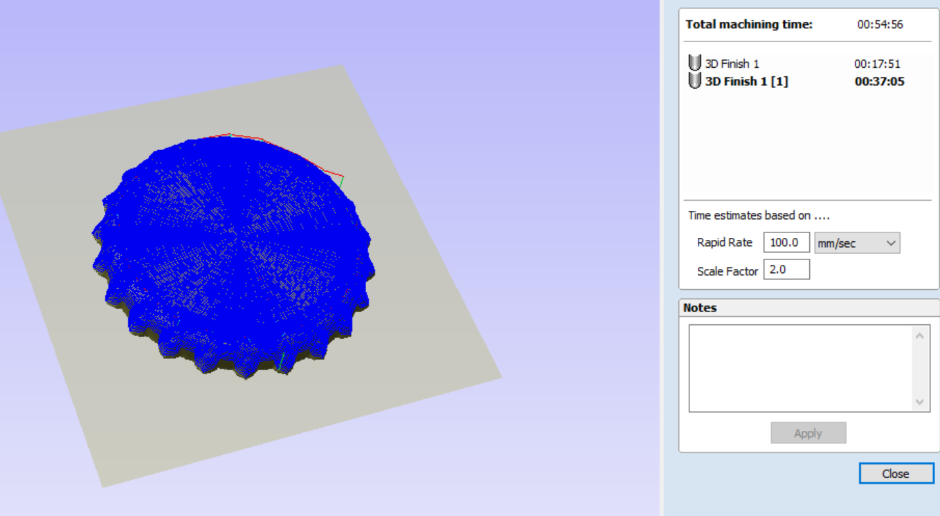

Vector 1: create vector from model boundary in the models tab
Vector 2: a circle
1/4" Ball nose, 100ipm 8% stepover. 17 minutes
By comparison, using the model boundary is going to more than double my time.
This is pretty much what @DarrylKegg said, just with photos
Also, what @PhilJohnson said. 1/4 ball nose for the win.
