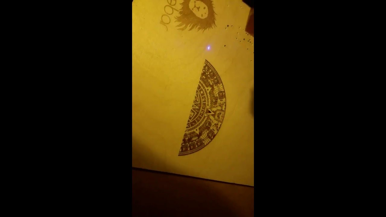

I have been running the 2.8W laser w/ the 2.5A driver board for a few months now. In the beginning I had some issues w/ PWM but I have to caulk those up to user error - they got fixed when I reseated all of my terminals.

Anyway, untouched (with settings or similar) the PWM power range should be between S1200 and S18000. S1200 is your laser-focusing setting and won’t burn anything. S18000 is obviously full power at your driver board’s current jumper setting. The range where you’ll get discernible results is probably between ~3000 and maybe ~10000, depending upon your amps and the material being cut/engraved…anything above that (on wood, at least) is pretty much the same result. I don’t remember the corresponding amp readings at these PWM values. The other common PWM commands of M3 and M5 work as advertised, and I do nothing to the GRBL environment when switching back and forth between laser and cutter.
The only changes I make when I need to do engraving are to the GCODE that is generated by vCarve (where I spend most of my design time). Those changes are pretty simple, mostly in addressing unwanted Z moves and turning the laser off then back on when you’re doing G0 moves between “carving” areas. I wrote a PowerShell script that does a couple of find-and-replace actions and then FTPs the resultant GCODE file to my workshop PC (a Raspberry Pi).
