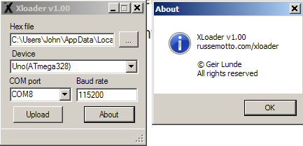

There is a known issue with the GRBL delivered on Xcontrollers in that time frame (Mine was affected as well). I believe that the issue was an incorrect version of 1.0c was loaded at the factory. Contact Inventables to have them walk you through reflashing GRBL on your Xcontroller.
That could fix some of your issues.
Off topic - but short
Jan, it’s really easy. Take a look at this thread for using Xloader.
Phil, I never type it in. I just point to it in the window that opens by clicking the button besides the file name box. Sure is easier for these old eyes.![]()
I did not realize it was usable from a Dos window. ![]()

Edit - My version:
I posted an alternate method for firmware updates that doesn’t use Xloader. I think that Is what Phil is using.
