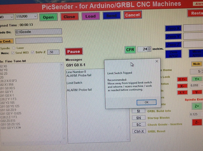

This is the message I receive when I send the code to the machine.

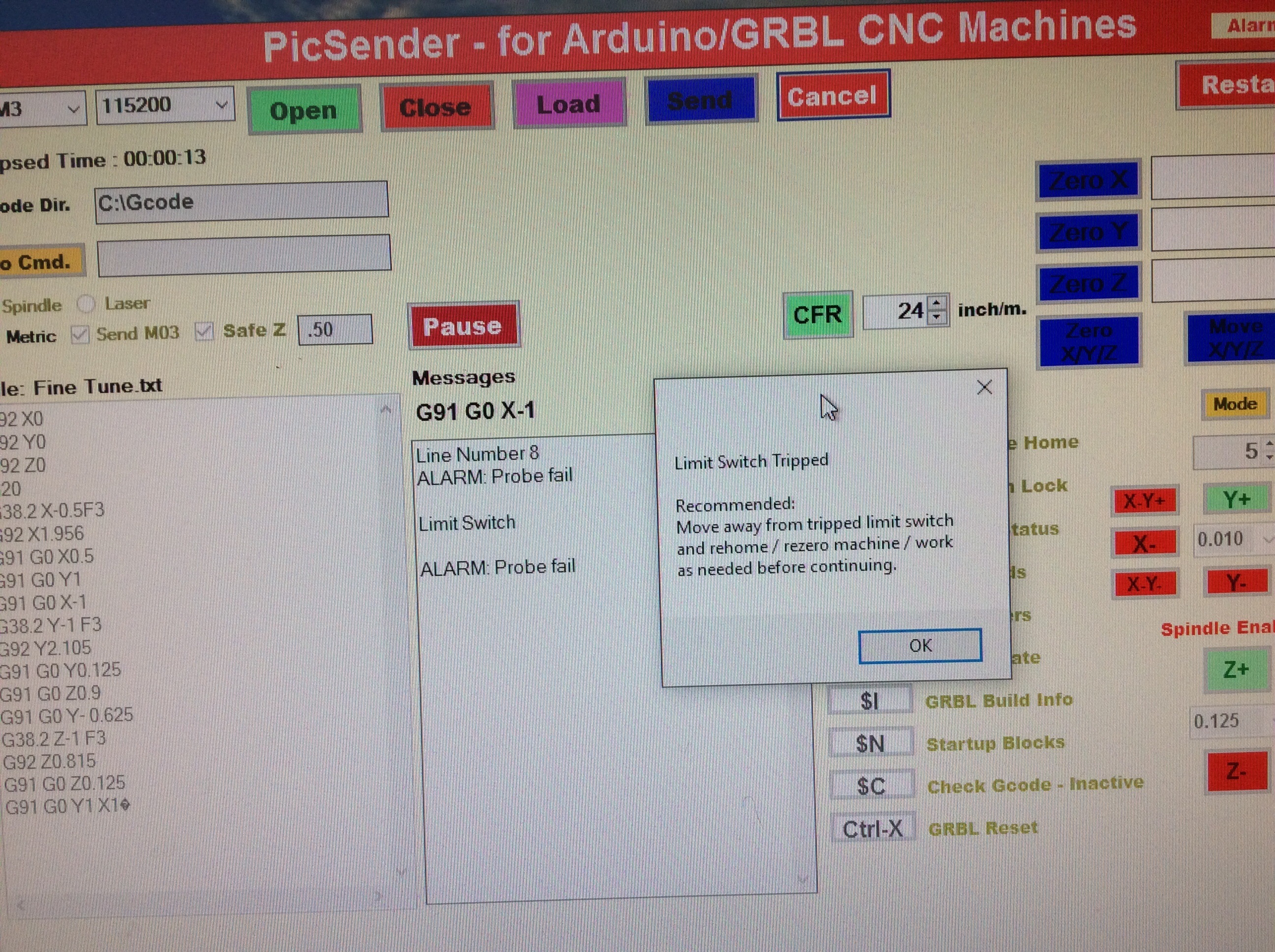

This is the message after I home the machine and press send.

It appears that you are starting the gcode run with either a shorted probe connection, or you may have a limit switch noise problem. The âALARM: Probe failâ message is straight from Grbl, so my guess is you do have a probe grounded issue.
If you are holding the probe plate in position with your hand, your body may be acting as a ground and closing the probe connection. This might happen if your AC power source is not grounded properly. Please try to make sure your AC power source is grounded. You can also try to run the code without touching the plate with your bare hands. Does it then work?
If you do have hard limits enabled ($21=1), and you are not using some form of signal conditioning, then noise may be tripping your hard limits. At a minimum, a 0.01uf ceramic capacitor should be installed between each limit switch input and ground, when the wires connect to your controller. I also recommend a capacitor on the probe wiring as well.
To test for limit switch noise, set the Grbl settings $20=0 and $21=0 and retest. If it then runs to completion, you do have a noise issue.
EDIT: Correction - 0.1UF ceramic capacitors, NOT 0.01uf.

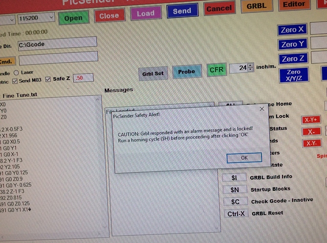

No I am in G91. I keep tripping the alarm lock.Where can I get the ceramic capacitor you are talking about? Looks like my Grbl settings are already set to $20=0 and $21=0.

Thanks, your settings show that limits are not activated, pointing more to your probe wiring/connection as an issue.
