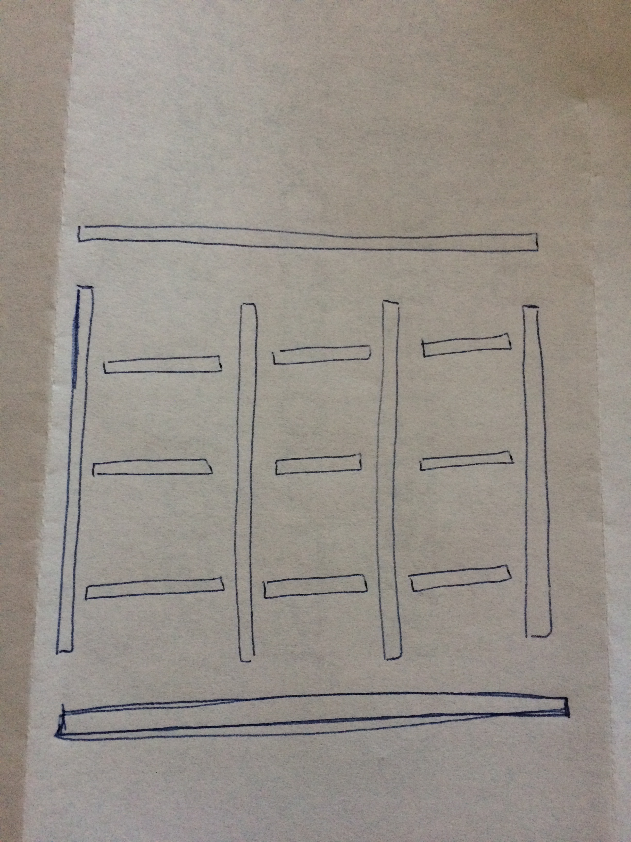

I disregarded the stock table bc it is not very ridgid and I am not using these pieces at all. I have based this decision on the Cubed Root Rule for stiffness. Think of a guitar brace, the taller the braces are, the more stiff the soundboard is. I upgraded the foundation of my table to the 20x40 for the extra stiffness
I would also replace the cross bracing with 20x40 as well. If you want to use the 20x20, use six 20x40, 4 of which run parallel to one another (could get away with 3) and two perpendicular to the others on the ends.
Use the 20x20 to tie the 4 parallels together. Keep the 20x20s as short as possible, they will have the most deflection.
This setup will stiffen the entire wasteboard. Just using the 20x20 in the center will only stiffen the perimeter more. This will allow the center to sag, possibly even more since the center will technically be floating 20mm above the surface of the support table. Adding the 20x40 across the center of the wasteboard will be necessary if you widen the perimeter supports as well.
Donāt get me wrong, IF the supporting table is sturdy enough, the 20x20 will suffice. Just keep in mind that the 20x20 will be using the support table more than a 20x40 to obtain the same amount of stiffness. This will require connecting the two together to act as one unit.
Michael Grigg: Could you provide a drawing of what you are describing? Iām having a hard time trying to visualize all the cross bracing you describe. Thanks.
Here is a quick free hand sketch.
The long pieces are made up of 20x40 extrusions where as the short pieces are made up of 20x20 extrusions. I still recommend using 20x40 extrusions for ALL of the base but this process will add more ridgidity over the stock base. And allow the use of the 20x20 extrusions.
This method does require more connecting hardware, but thatās a given bc there are more pieces and more intersections to stiffen up.
