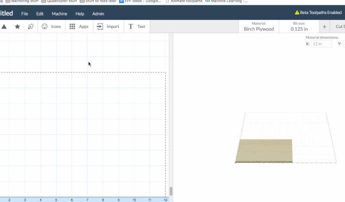

If you guys are having issues, please send an error report with the machine connected (green carve button) with a description of whats happening. Heres how to do it:
