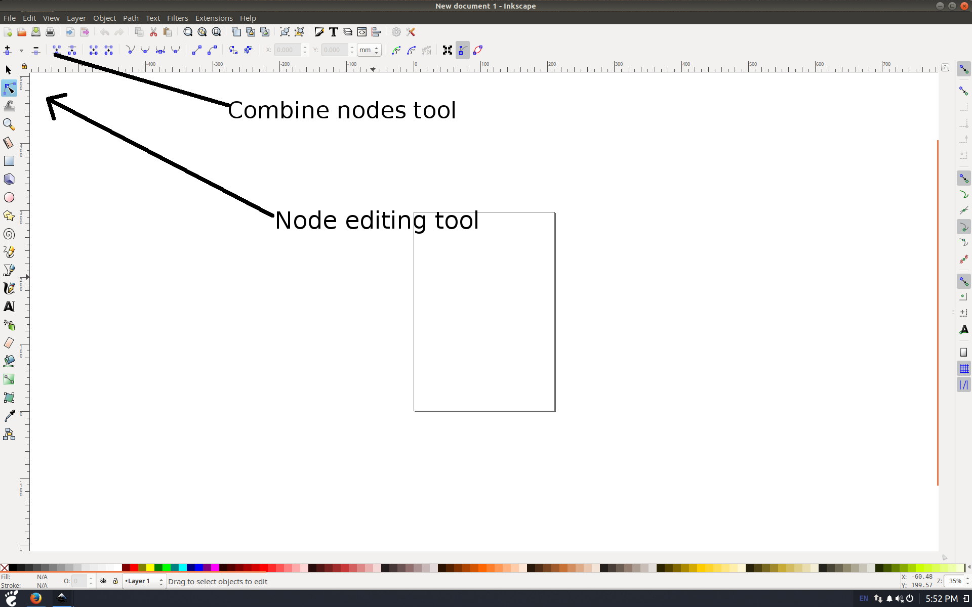

First time I have posted so I hope I am not out of order. I have spent 2days trying to import Brian Law’s clock test into easel and I have failed! The file is dxf but won’t open in Inkscape, I can open it in fusion 360 and it looks good. I have been able to clean it up there and export a dxf to open in Inkscape and this file will open, but there are bits of the all over the place. I tried a script to join polygons which seemed to work but when I exported the dxf and opened in Inkscape there were still displaced bits. Am tearing my hair out and there is not much left! Any help would be very gratefully received. http://www.woodenclocks.co.uk/page73.html
Wow, it came into easel perfectly. Thank you so much Kenneth. My next question is of course how did you do it? This was a trial but I am hoping to purchase one of the clock plans and convert to svg, so I would be really interested to know how it is done.
Thank you for taking an interest in learning. I really am glad to see that.
All I did was open the DXF file in libre-cad (open source program) and then export as maker-cam SVG to local drive, then open with Inkscape (open source program) and select the unwanted lines as nodes and delete. then selected shapes (they were grouped) and ungroup so that I could edit them individually. I then selected each shape with the node edit tool and selected all node and then connected all nodes that were touching. done.
Thank you for the information and for taking the time to show me how it is done. I was able to create the svg, bring it into easel and cut the parts in a short time. I am looking forward to starting work on the clock shortly. Once again thanks.
