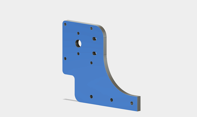

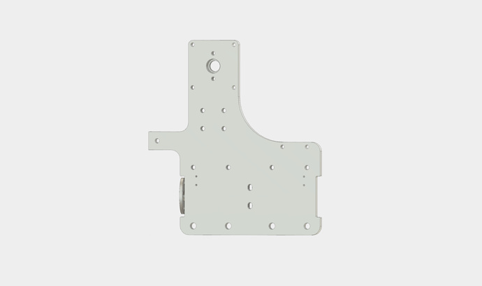

Here is a kick back to one of my prototypes that took a lot of time and money to make but ended up as a failure:
Some critical dimensions were off and the fit and finish was way too expensive to meet the price projections.
