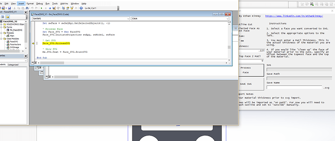

I never really worked with macros before and ran into another run-time error (â13â Type mismatch).
Here is a screenshot of the Debug highlighted text. let me know what I need to do.
Thank you.
Mind showing me a screenshot of your model and feature tree? A few things could be going wrong. Unfortunately the line in the debugger is for the whole class⌠so it really could be a lot of different things.
