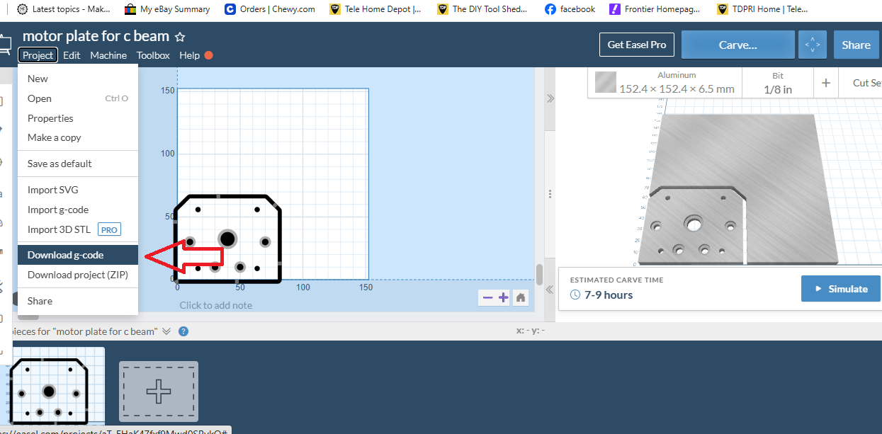

Open your Gcode file in a word processor and see if there is an M3 command near the top of the lines of code. If you are running right from Easel, you can download the gcode and it should be able to open it . It should show up in the downloads folder.

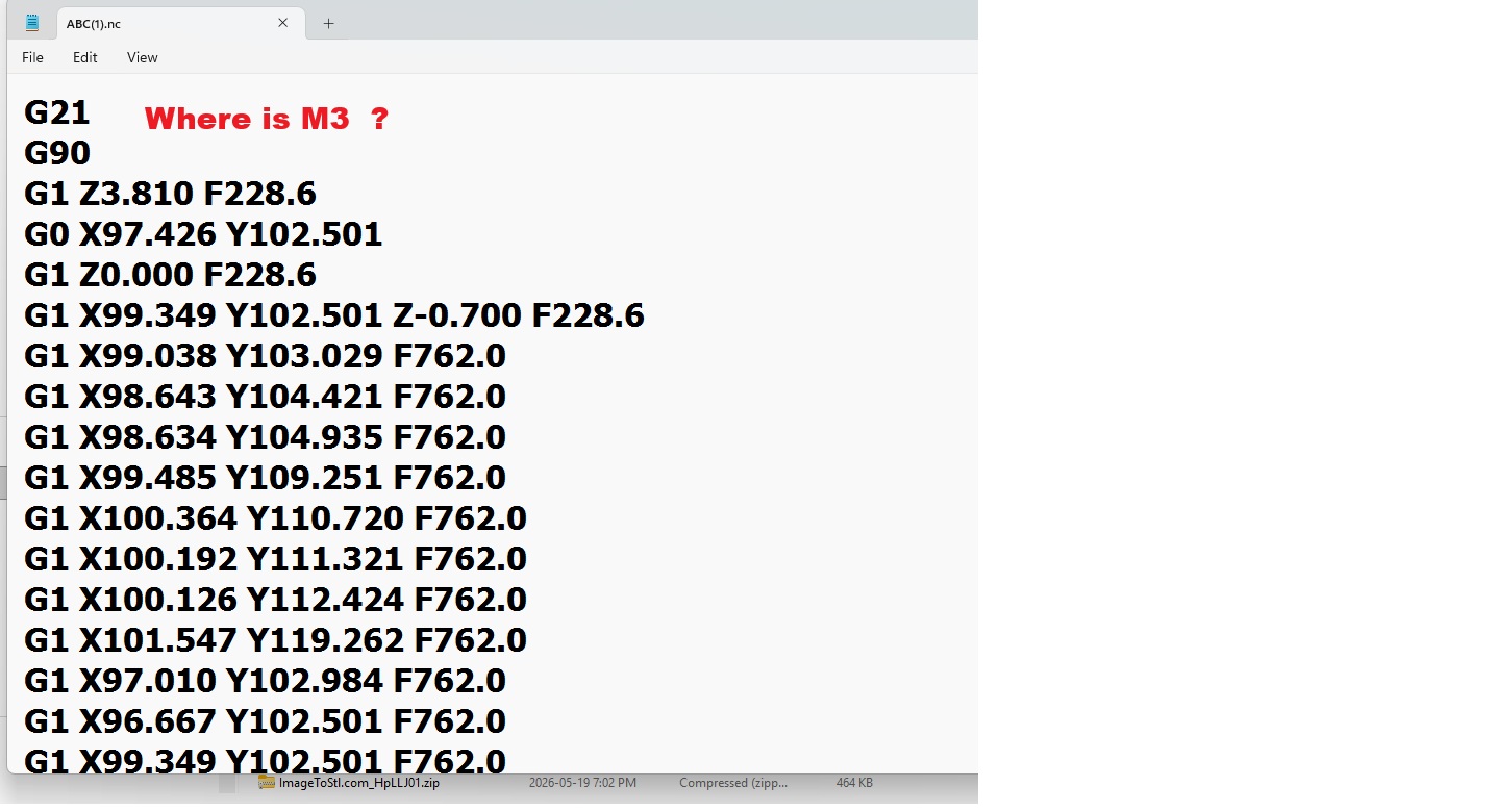

When I create a file in Easel today and I look at G codes There is NO M3 command for spindle. This has just started last 2 days. Previous files all had a M3 S1000 code without any input from myself. Has there been an update I am not aware of?
Why is there no spindle command?
This is why I suggested that you go through the machine setup. One of the questions is are you using a spindle IIRC. It’s a choice between automatic and manual.

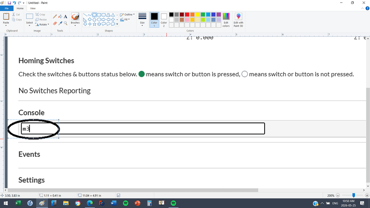

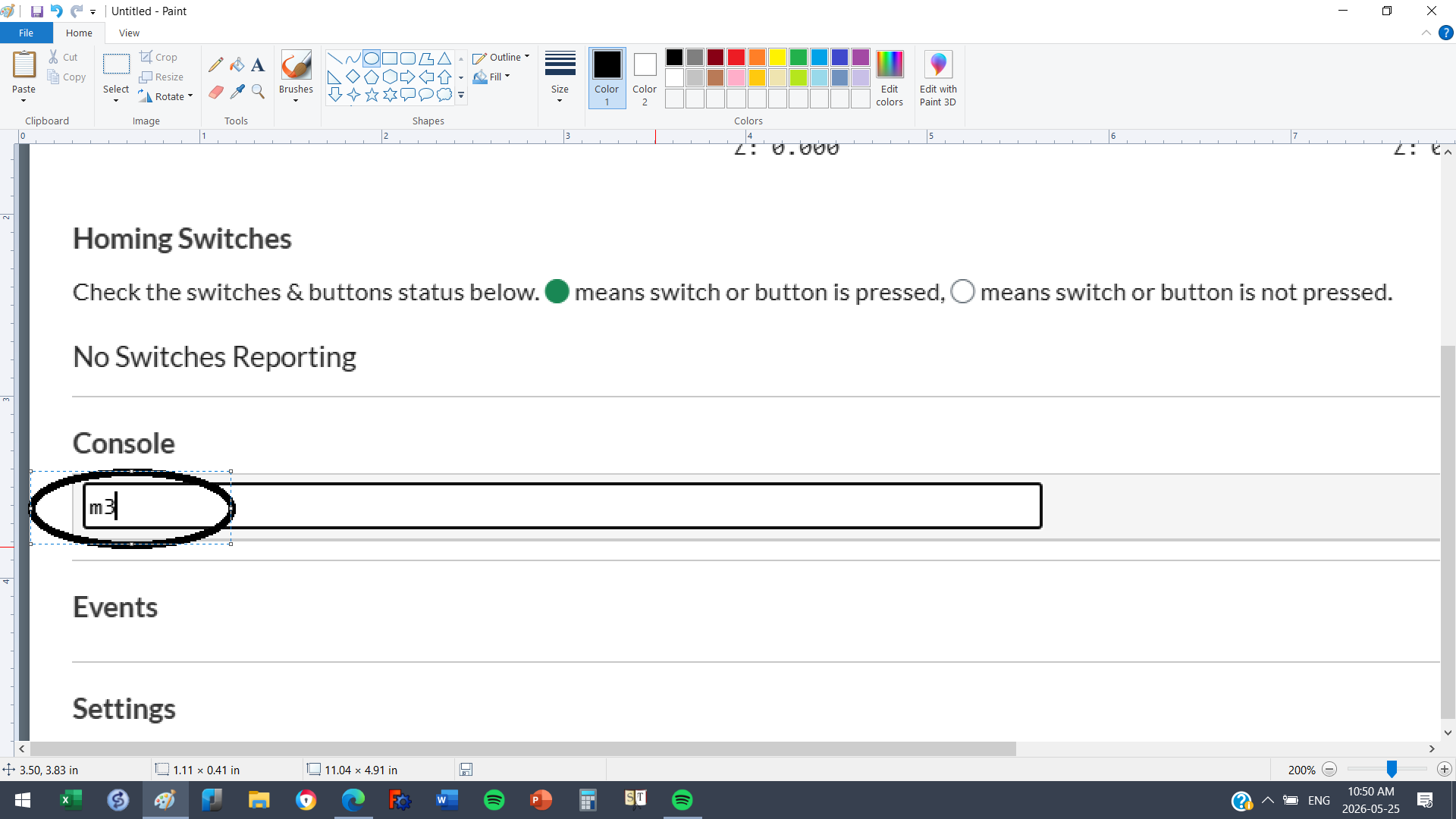

try going to machine inspector screen in easel and type in M3 Motor on and M4 Motor off
Does the spindle now turn on?
Oops, fat finger symndrome sorry
M3 - on and M5 - off
