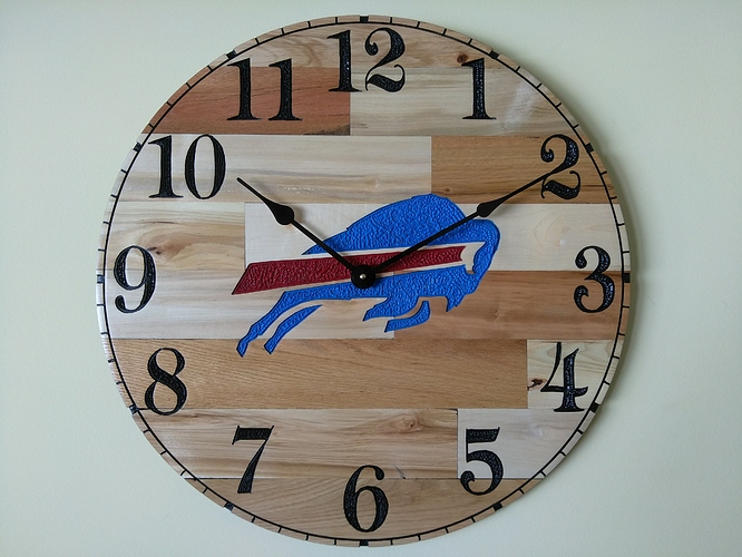

Steve I know this is your thread. Iām only posting these photos to show the painting process I have used and to add to the discussionā¦not to display my work. If you want me to remove I have no issue with that.
I did the razor method on these. I donāt have a CNC yet. These were routed by hand with a palm router. For the numbers on both and back ground of the Bengals clock I spray painted with black ink and sanded clean.
For the logos I did cover the clock with newspaper except right over the logo area I used a masking made from painters tape and took a exacto blade to open up the areas I wanted to spray. For example on the Bills clock the red part would get cut open and sprayed, let dry and then I would cover the whole thing again and cut out the part to get painted blue.
