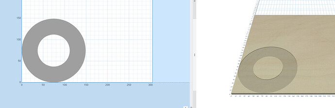

ok, I think im close to a solution and the answer stinks. I downloaded adobe illustrator so as to compare file output and easel input. as you can see in the first video, it looks to be the same as far as exporting.
next I added the files into easel and as you can see the SVG produced by adobe illustrator works perfectly. the affinity svg on the other hand performs like a butt. so somewhere in the output Affinity is doing something different than AI and creating a file that doesn’t work

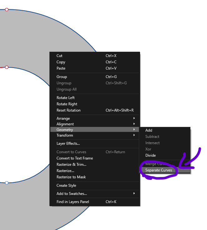

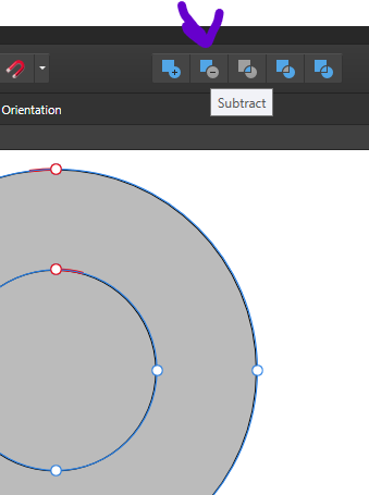

Before I forget, I wanted to tell you what I did to make it work.
When you separate the curves, reverse the inner path. Then do the subtract.
I’m not sure if this is an Affinity Designer issue or an easel issue.
I can explain more if needed.
Im almost understanding all of this. the only issue is the reversal of the inner path. in which software do you reverse the inner path? affinity or easel?
ill check it out. thanks a ton. im not really versed in the “guts” of these programs and trying to mach up the two wasnt really a good adventure for someone like me with limited knowledge. i really appreciate the time and effort youve made. im going to give it a go now. thanks a ton. jonny
Donut
Convert to Curves
Separate Curves
Select Inner path & “Reverse”
Select Both and perform a Boolean “Subtract”
Export
how does that behave in easel?
So, after all this, I’m calling this a bug in the way Easel handles the SVG fill rule property.
@Ben-Saks
I think Easel should handle the donut without the workaround.
Thanks so much. this is exactly what I was trying to figure out! exactly this. you couldn’t be more right. from the beginning you had called out the Boolean nature of the problem. this fix creates a lot of potential for what I want to do with this software. I’m sure ill have another whacked out question within a week. I’m very grateful for your help. have a great holiday.
