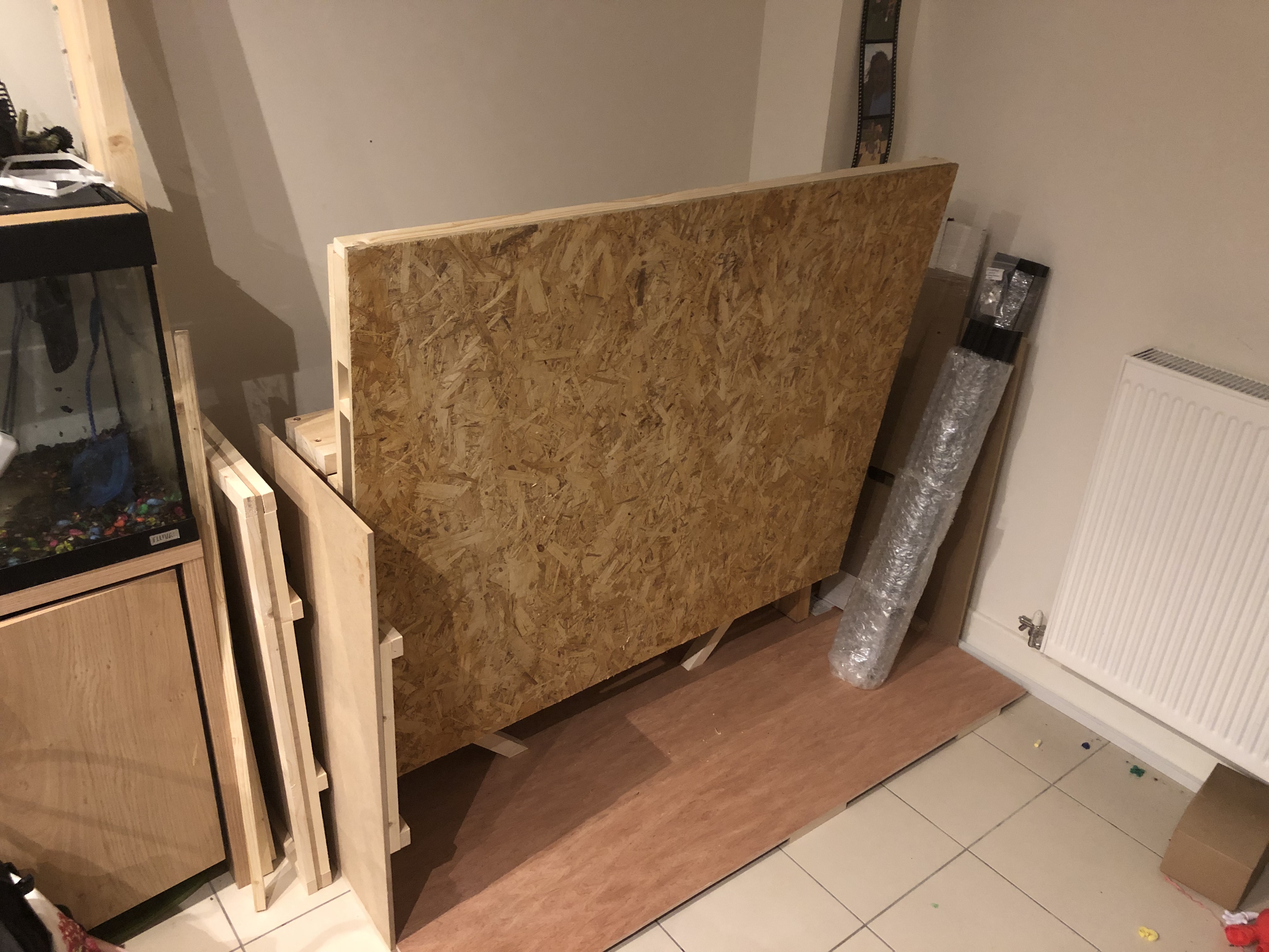

The igs file I opened in fusion 360 it’s all to scale there. I think it’s been a while. But I remember being in the same position not really have the step by step. Mine changed slightly to fit my needs as well. I have a tower not a laptop I cut a hole in the side to keep things plugged in. I added magnets to the legs

I would love the plans and measurements for Matthews original folding table or even a close modified version. I have started receiving my boxes with my new 1000mm xcarve today. My original plans on housing and mounting this machine fell through. So I’m stuck working under a carport with limited storage and space options. Any help would be great.
I made mine 60" wide by 18" deep. 34" tall. I made the torsion table 46" wide by 42" deep. The strips in the middle of the torsion box are 2.5". Those are the main dimensions I think you need to get started.

Did you follow plans to build that cart ,or is this your own design? I have VERY limited space and would like to do a cart fold up design on wheels. Yours looks perfect.
