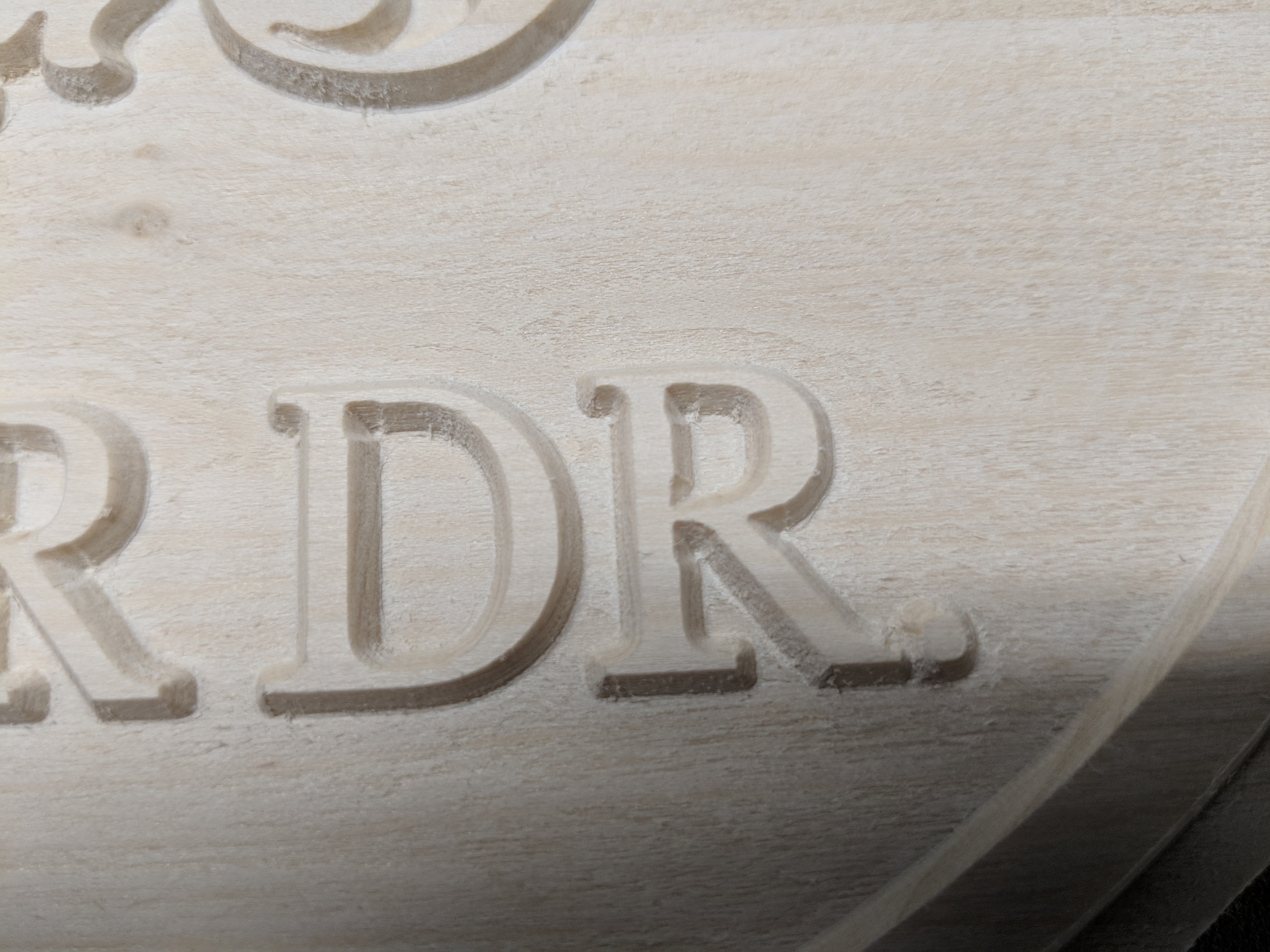

I did some v carving for the first time with Easel Pro yesterday and the carve was looking really good until the very end. While running the final pass to clean out the corners of the letters it ended up cutting out more wood than it should’ve.
I was using Inventables 60º v bit that comes to a sharp point and used all the default speeds and feeds. Also, the simulator doesn’t reflect anything strange going on with the tool path in those areas.

Your bit is not a true point. Turn it around and you’ll see a flat.

Has anyone had any success with the 60º bit that is sold by inventables? Based on what is being said it’s not the bit but the paths? Is this strictly an easel issue and how easel deals with the 60º bit? I have not had one successful carve with the 60º bit because of the corners being blown out by a final pass. Looks great until the bit comes back and plunges all the corners.

Thanks for the input Brandon. I’m assuming your using Easel? When I generate paths for the 60º bit it does fine until the paths return to sharp corners to “refine” them (I’m guessing). This causes all the corners to get blown out. If you don’t have this issue and it’s a user error on my part I’m all ears. I would love to be able to get past this without buying additional software.

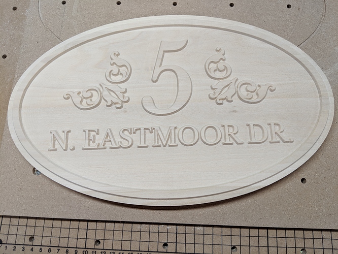

Yeah, I use Easel Pro and have not had any issues with corner blowouts, unless I am simply misunderstanding what you mean by them. The only time I have an issue with anything is if my wood is not level and I end up with different depths of cuts. That’s my fault, though, for not planing the surface first. Here’s something I did a few months back. It was one of the first v-carves I did with Easel Pro. The notched corners and routed edge were done by hand,not Easel Pro.

This is the only one I have a picture of at the moment. I scrapped it because I forgot to plane it first and the depths of cut became an issue. I also misaligned it so it was a nice learning moment for me. Maybe you can see examples of blown out corners that have been mentioned. I would have been perfectly fine with this sign if human error had not been involved.
I like that by the way.
More specifically I was looking for relief text done with EP and v bit, such as the stacked text wedding signs.
