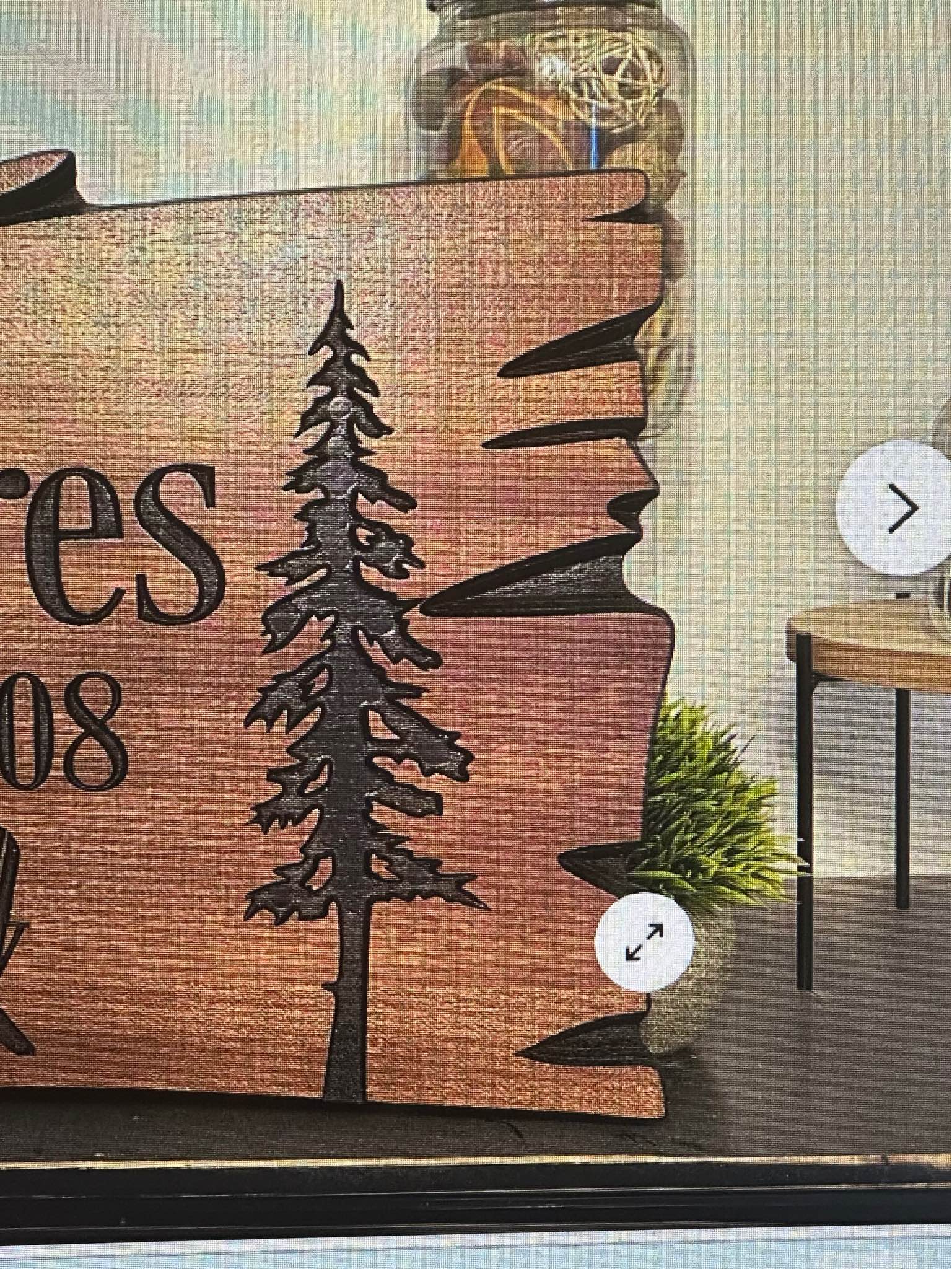

My machine is a Genmitsu 3018 PROVer V2 - This picture is from someone else’s post in another group and was done with a different software. I love the “edges” on this. Is this possible with Easel Pro and if so please help, how. As I said I have mostly been doing the image import so talk to me like a 1st grader LOL
If you are talking about the fake live edge look, Yes your machine can do it. You need a 3d drawing software. You “might” be able to do something in Easel with the gradient app.
I drew a block and 4 cylinders. I rotated them to different angles and then split the parts and removed what I didn’t want. This is a simplified way to do something like you want to do.
live edge
Thank you going to give that a shot
