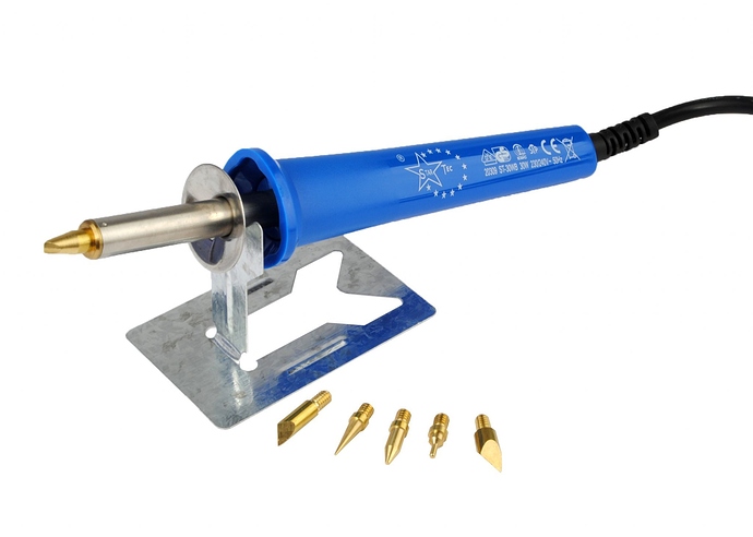

Here is my woodburning tool
I had a 50% off coupon for Michaels so it only cost me $12
25 watts
