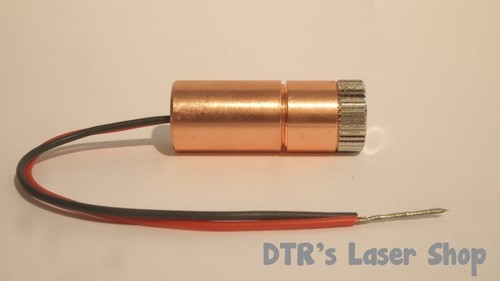

im planing on buying the jtech photonics laser kit of 2.8 watts, but i think it might be too weak, so i looked on ebay and saw a 6 watt laser diode for about 90 dlls, and was thinking if maybe i could buy the driver from j tech and put that 6w laser, but im just starting in this with laser and wanted to know any opinions or advices, thanks.
here is the driver
https://jtechphotonics.com/?product=2-0-amp-adjustable-laser-diode-driver-oem
and the laser
The J Tech driver can only provide 2.5 amps. It will not drive the six watt laser to full power, that requires up to 4.5 amps.

If you would like to have a little longer lifetime I suggest to run the diode with ~3,5A current.
You will obtain 6W anyway with this current.
Proper cooling is one of the most important things. I suggest to prepare a heatsink with the hole where you can press the 12mm diameter diode housing in (with some force) and use additional FAN with high CFM rate. Lower temperature makes the diode’s lifetime longer.
Proper lens are also very very important. Highest power does not mean highers engraving speed.
Very often three element lens gives you bigger power density.
