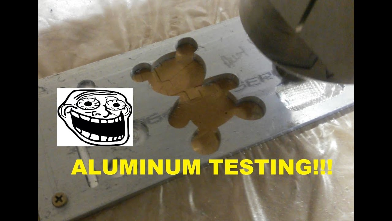

here is a video of working in some aluminum with a single flute I got an amazing surface finish right off the machine
V-Carve the fine lettering. If you do not have V-Carve, use F-engrave. Use this bit:
http://www.ebay.com/itm/122091063712?_trksid=p2060353.m2749.l2649&ssPageName=STRK%3AMEBIDX%3AIT
Look at youâŚ
there you go !! nice is that using that 4 flute tool?
.25 4 flute @ 75ipm .005doc
could have pushed its either harder or faster. not sure which is better.
Keep the speed here and increase your DOC slowly. Then - remember to record your settings somewhere. So many materials, bits, speeds, feeds - you need your own database. Those chips looked great.
i thought they looked kinda small. the bigger the chip the better.
with the new rail and extra y stiff mods it cuts to a decent finish.
