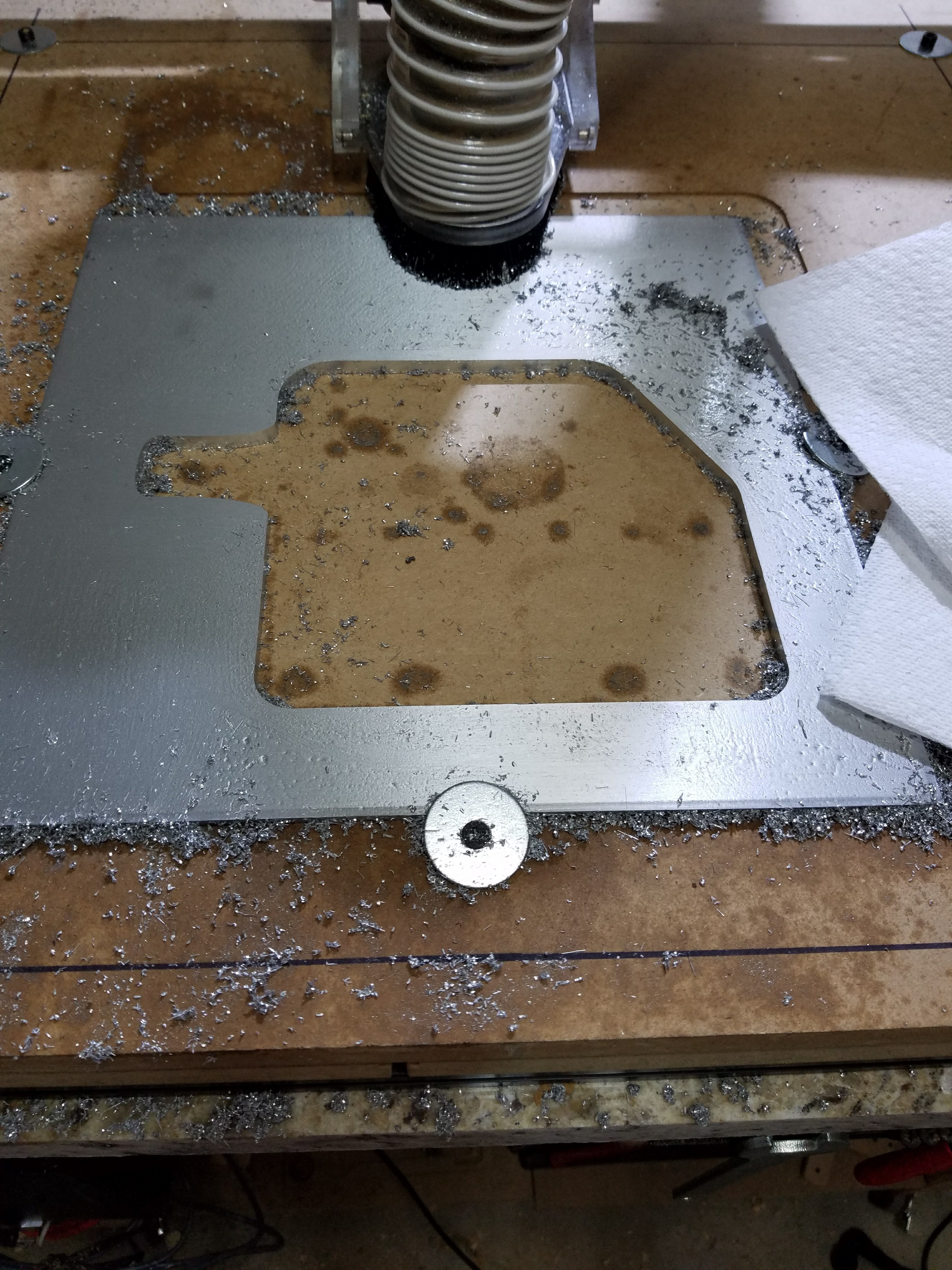

one way to get a good outside surface finish it cut the part over size by .010-.020" radially but cut axially all the way to final depth with conventional milling
and then plunge the tool straight down to full depth and run a pass at final radial dimension using climb milling
that will give you a great surface finish
how long did that take to cut out?
might try .020" DOC

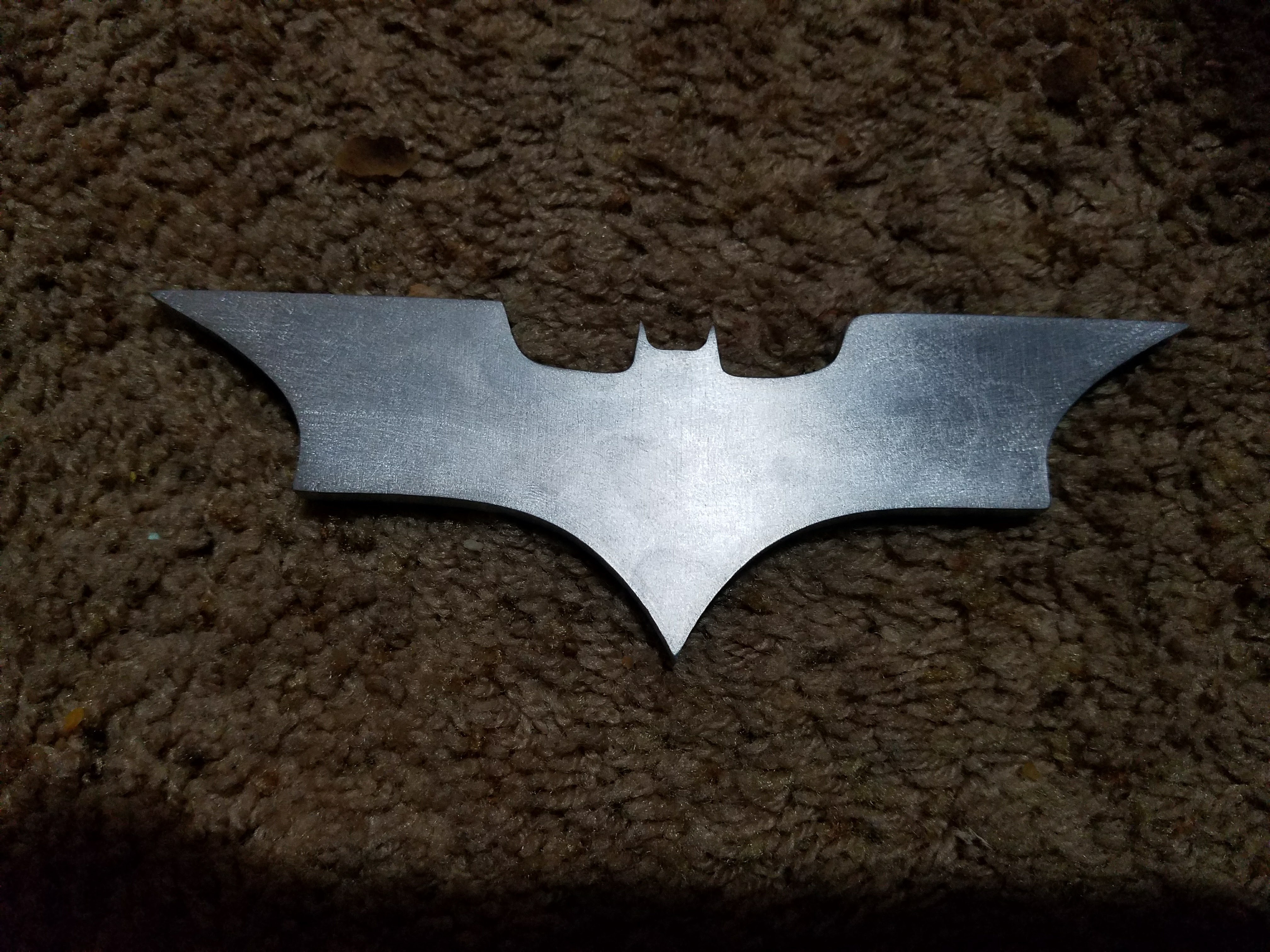

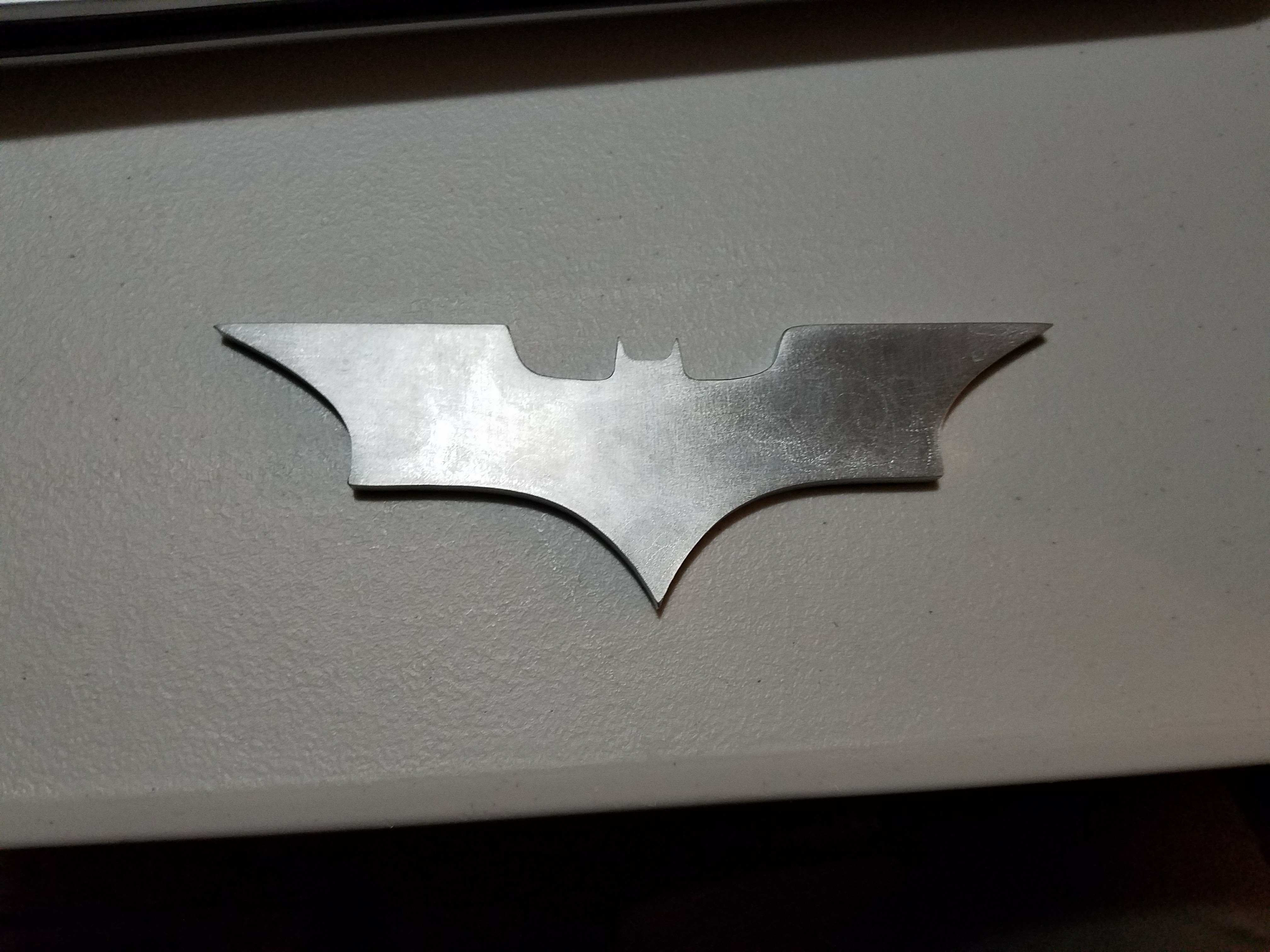

That’s a really good finish :slight_smile:
Can you tell me What rpm (knob number) are you using here ?
Using @WorkinWoods suggestion what i do is to over size item by .10 or .20.
Cut using the most aggressive settings that is “safe” aka nothing breaks.
My latest and greatest results were:
Speed setting 1 @10600 rpm
Doc .005
Ipm 140.
Was able to cut a 1/4"x10.5"x3.5" batarang from aluminum sheet stock in 10-15 min. I used fs wizard online and used their recommended settings.
To finish nicely i set the doc to a little past the material thickness and set the material to .26 or .27 instead of .25 or .24 and made sure to compensate the tab heights as well so it wont pop out.
Then I adjusted the size once more back to what i wanted and ran a finish pass at over full doc and speed setting 6 with 50ipm.
