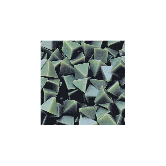

I then tumbled the parts in a rough/de-burring media for 45-60minutes.
A single trigger plate cleaned up, post rough.
