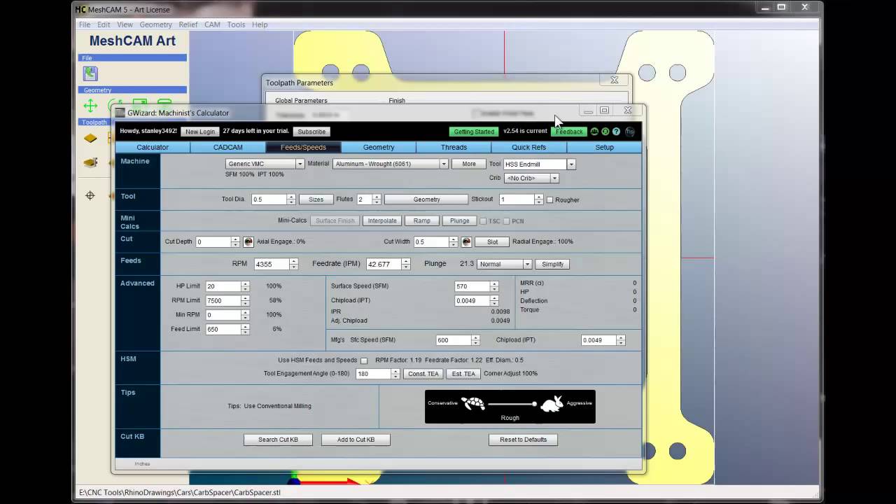

This is from this link: 3D CNC Milling & Machining: CAM Toolpaths

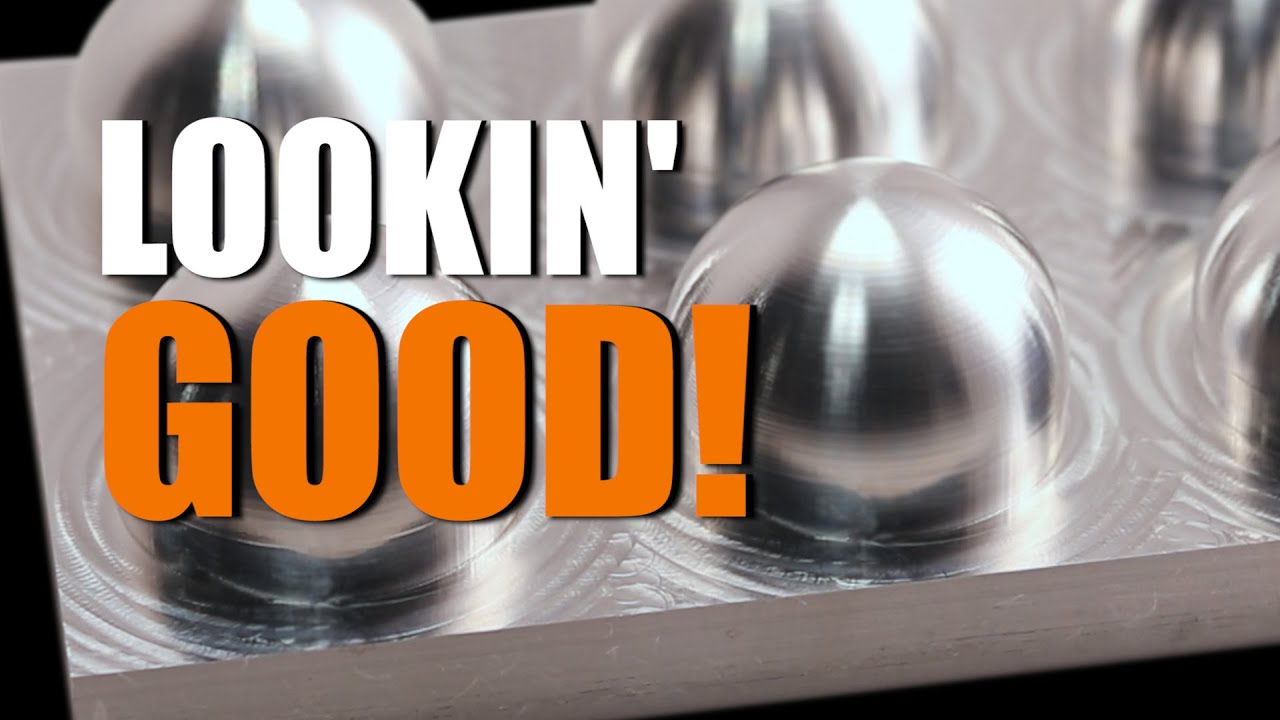

There is a great recent video from John Saunders (NYCCNC) on youtube about cutting out half-spheres like you have above. Comparing different strategies and tool angles. It was informative: (the one big disappointment based on the title is he really only tested half-spheres since the obvious elephant in the room is “op 2”.
