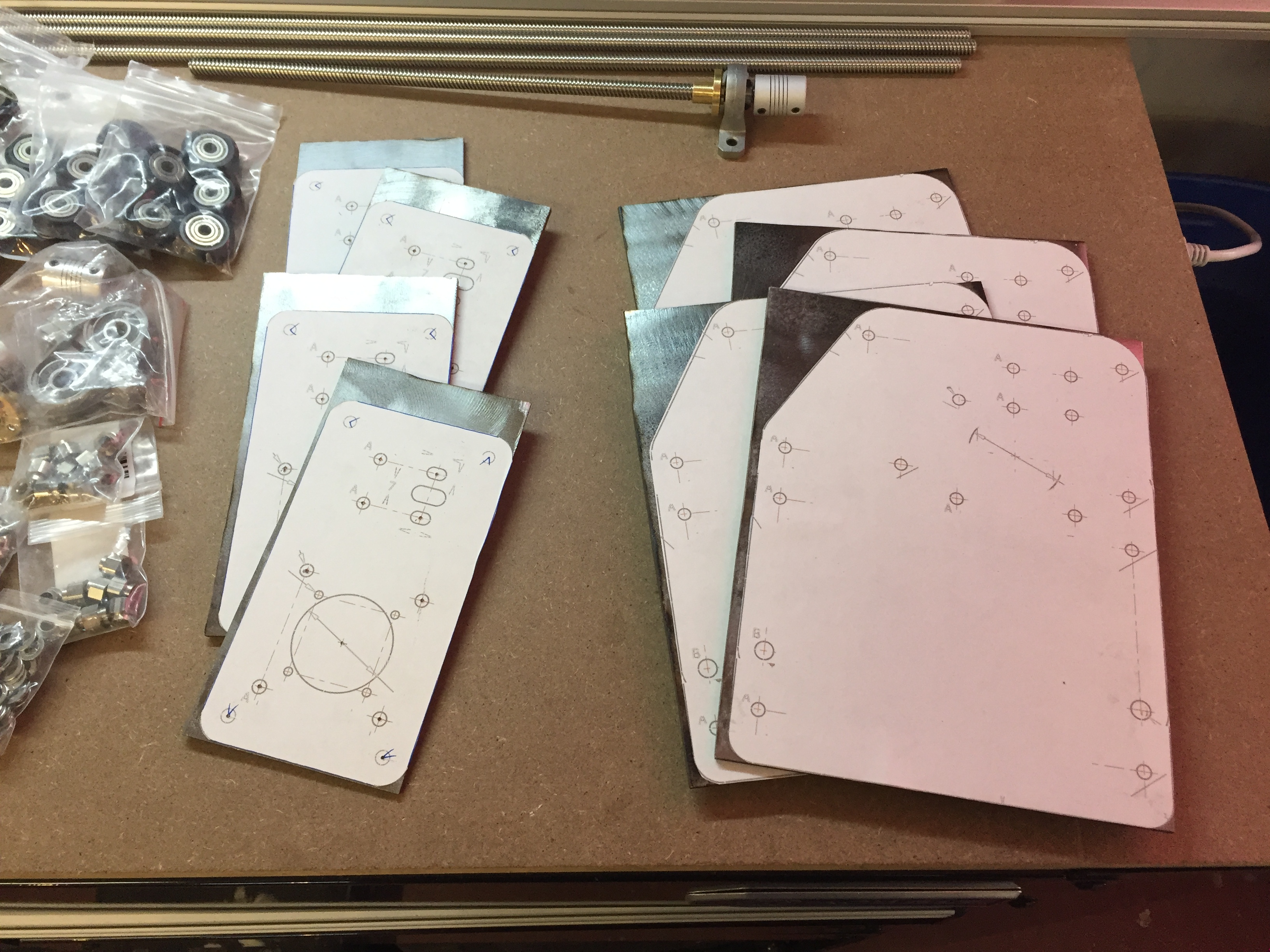

Just a sneak peek at my idea of using wide MakerSlide for both the x and y axis. (Video)

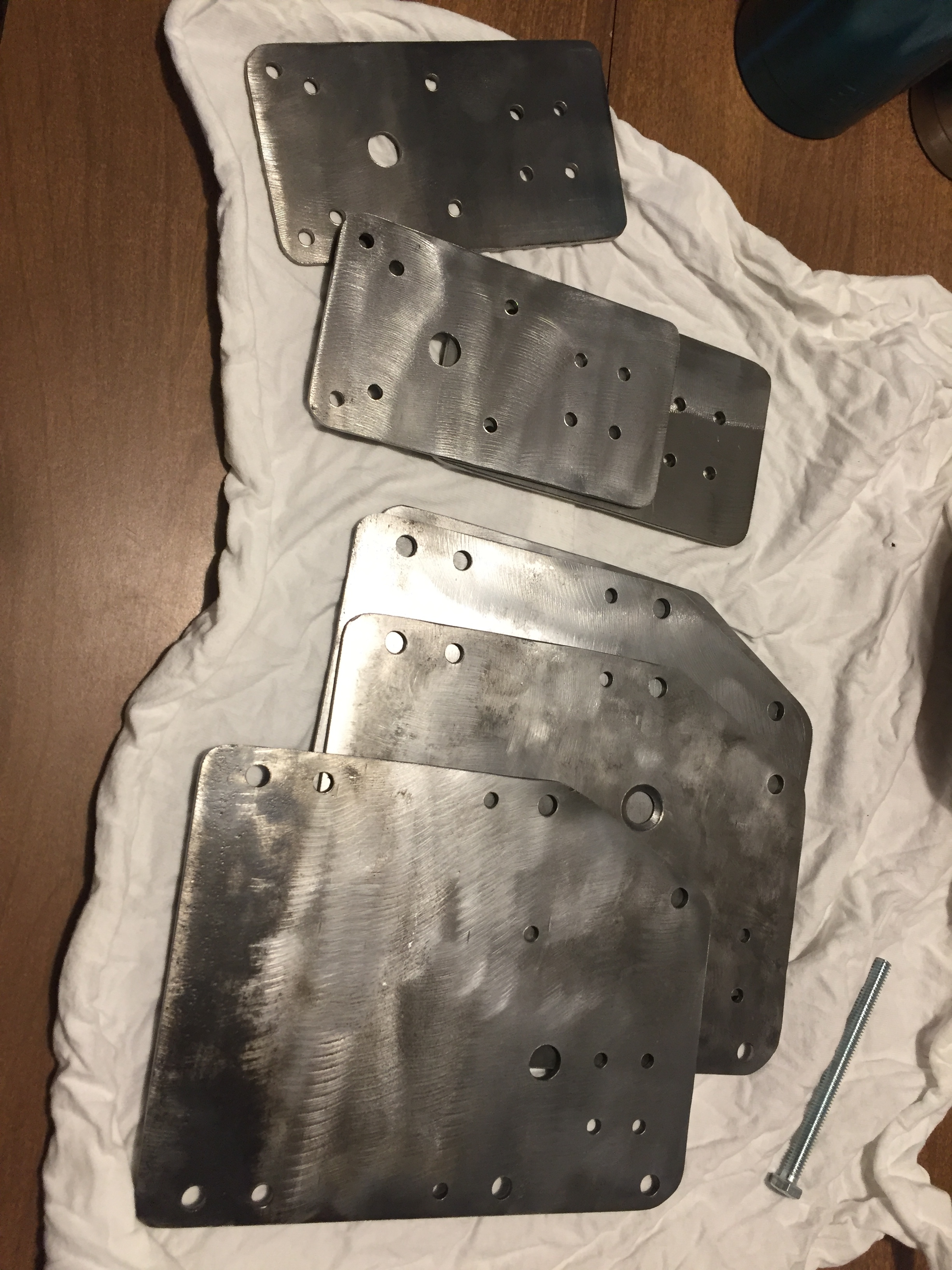

Hi, what is the distance between the 2 Y rails now? Did you cut your own side plates? I don’t think I saw them in grey before.
The steel plates are all cut from some 1/8" scrap sheet metal I had. When I’m finished building I plan to take it apart and powder coat. All of the wide MakerSlide is 1000mm.

I see, nice work on the plates.
