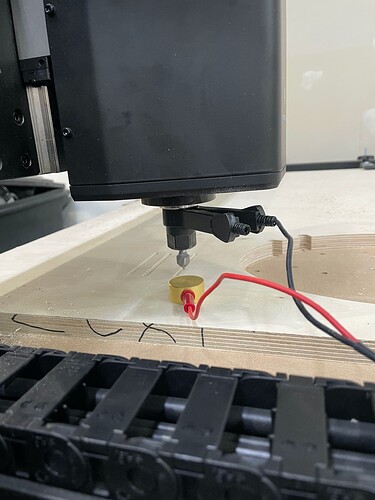

I obviously reset the Z axis with the probe in between bits, but for some reason the machine is carving deeper than it should.

It is a perfectly flat piece of birch ply. I set my Z in the same spot every time, no obstructions.

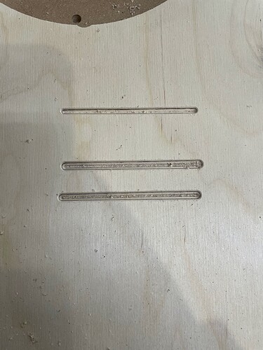

As you can see in these photos, the shapes are all being cut at various depths.
This was just for test purposes, but I would stop and start in between every path.
I am setting the Z in the exact same spot every time.
This machine is a few weeks old, with very little use so far, I have checked the lead screw and it looks perfect.
The material is secure and clamped down with no warping. totally flat.
