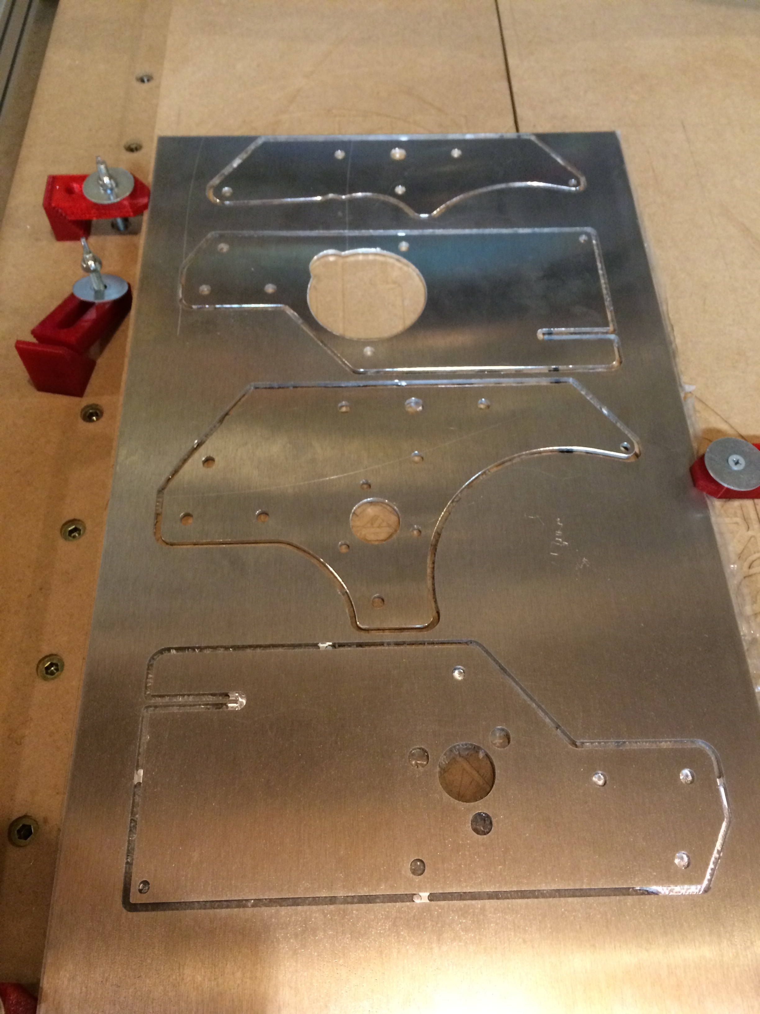

My good friend Scott Kelley suggested that I share an update
on the buildout of R2, in particular the Drive Motors for the feet. They are
constructed from 1/8" Aluminum plate, bolted together with hollow spacers.
It uses a pair of Razor Scooter Motors and wheels. The design is based on the
ATLR2’s design, which they were nice enough to share with me. I was able to
import their DXF files into VCarve Pro and produce the Gcode in a matter of
minutes.
I did several test cuts on 1/8" hardboard first to
verify that everything would fit together. Only after everything look right, did I try
cutting the Aluminum.
Cutting Aluminum has many challenges, Speed of the Cut,
Speed of the Bit, Type of Bit, Slop in the Machine, etc. I found that if I cut
too slow, it would melt the Aluminum to the bit and basically destroy the bit.
Cutting Medium speed seemed to do the trick, along with lubrication!!! I ended
up using a off the shelf 1/8” straight router bit from Lowes.
Cut Parameters: (End Mill 0.125 inch)
Pass Depth: .005”
Stepover: .05”
Feed Rate 450mm/min
Plunge Rate: 300mm/min
Yes, I do plan on sharing the files that belong to me, the ones that I actually created. The actual plans for R2 are available on the R2 Builders Site astromech.net. You will need to join as a builder to see the actual blueprints.
Steve Morgan was nice enough to let our makers space, Geek Space Gwinnett bring R2 to Dragon Con Sunday and he was a big hit. People were most impressed with the point that everything was done on a home CNC, the X-Carve.
Wow, that must have taken forever to cut at those rates.
Just the Aluminum took forever, about an hour for each panel, 8 hours total, so pretty much an entire day to cut all 8 panels. I was focused on quality of the cut, rather than the speed of the cut, as I am not doing production work. The wood parts go much quicker. I am still trying to sort out issues with oblong holes. Before the upgrade, I did not have that issue, so I am not sure what has changed, but suspect my V-Carve Settings.
